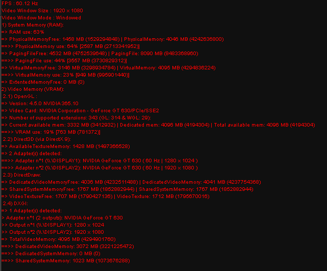

Here is a screenshot of the data provided by the FPS plugin (video paused to get a black background).
I will have to monitor VDJ for a while to see if the video freezing, frame dropping and other issues still occur.
