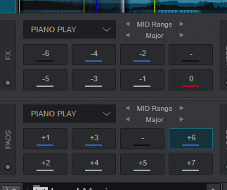

Have a "Piano Play" pads page same as the REV5 that will upload soon, but you need 16 pads for it like this ..
.. so not very suitable for controllers usually having 8 pads. The REV5 is a different story, has a firmware feature that makes the pads of the other side to work on the same Deck the mode is called from.
