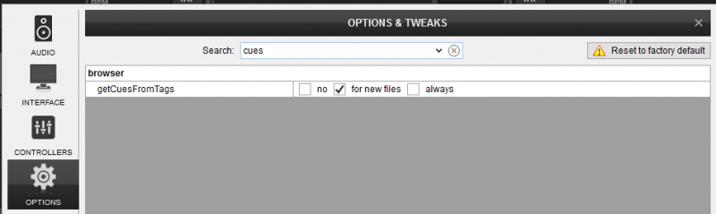

Reading Cues from Tags (where Serato stores them) is now available in VirtualDJ 8.
The setting GetCuesFromTag is the one that you may need to change, depending on when u want VDJ to read/get Tags (always, only for new files etc).
You may also need to batch reload Tags (right-click menu option)
