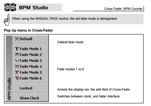

I am loving my journey in VDJ. So as I am a "newbie" to it (longtime Traktor Pro user) I like the automix option. But I am wondering if there are crossfader volume options.
I used to use BPM Studio's automixer because it had many options. In particular Option 6 (image attached) where the song playing fades out and the next track comes in full volume.
Is this possible?

Please read this : http://www.virtualdj.com/wiki/Crossfader%20Curve.html
Crossfader curves that are not "symmetrical" like Nr.6 are not possible though.

Indeed it is possible to have not symetrical crossfading with user custom curves (but maybe not in automix, dunno).
Example with fade mode 5 in the picture above :
crossfader_curve '0=[1,0]/0.5=[1,1]/0.501=[0,1]/1=[0,1]'

It works with non symetrical fades.
What you have to do is use the automixDualDecks option. Then the crossfader will fade with the selected curve, even if this curve is non symetrical I just tried it. The bad side being, you would have to change the crossfader curve for each incoming song depending on the side it is.
Example you just gave :
Fading from left to right, right kicks in suddenly :
You can even adjust it to swith the kick at 0.25 instead of 0.5, would render something better with how automix actually fades songs.
crossfader_curve '0=[1,0]/0.499=[0.5,0]/0.5=[0.5,1]/1=[0,1]'

Thanks fruit! I wasnt aware of that. I will play with that. However, I read that dual deck automix is depreciated, so that leaves some concerns.

Hey Fruit, as you said, it works but it would require changing the curve every time there is a transition to the other deck. I was thinking about if this could be accomplished with a script, but that would mean the script has to run in the background all the time during automix and checking for the currently playing deck. I wonder if this is practicable.
