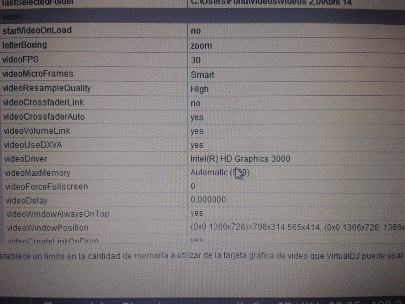

goto VDJ config/options and type DXVA on the search field (make sure advance option is check).
Posted Thu 21 Jan 16 @ 7:22 pm
It is set to yes by default
Posted Fri 22 Jan 16 @ 12:25 pm
In which case try disabling it.
Posted Fri 22 Jan 16 @ 3:56 pm

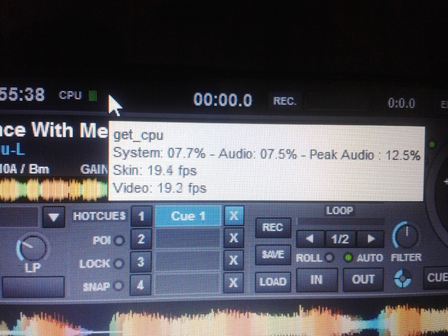

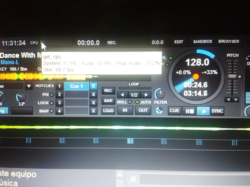

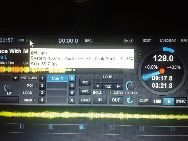

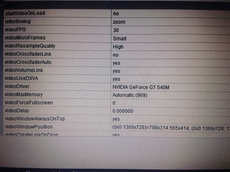

greetings, I am presenting the same problem in my setup toshiba laptop i7, 8-core, 6 gb ram, video card, Intel HD 3000 and NVIDIA GT540 1GB, Windows 10 64b
My settings skin is 60 fps and 30 video
Intel HD 3000, with audio and video without Fallen fps supporting up to 60 video, 60 skin, everything works smoothly
NVIDIA GT540, only 59.9 fps with audio, video opening is a lottery, the fps down for both audio and video between 21-23 for both, and occasionally when I have luck in the video is 31 fps and 40 fps skin .
anyone knows because he works so bad to use dedicated video card?
sorry my English is a little bad

To both of you - does everything work OK if you set your fps back to the default of 30 for both?
camplg what is your dxva setting set to?

sorry about that... i checked again and for some reason the DXVA setting was set to no. I switched to yes and everything is running smoothly.
Regards to all
Regards to all

I still have trouble viewing the skin smoothly using the dedicated video card, with DXVA option on or off, in contrast with the integrated card fluides the skin is excellent
dedicated Nvidia GT540 graphics, audio only

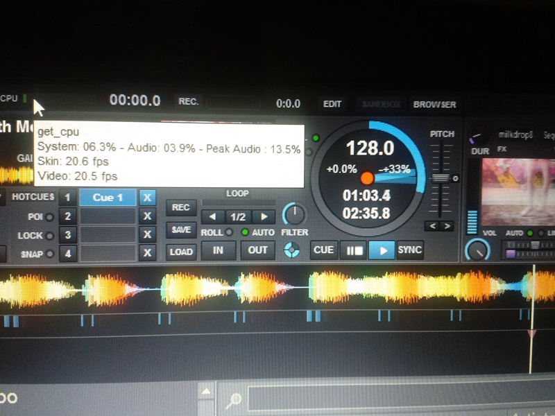

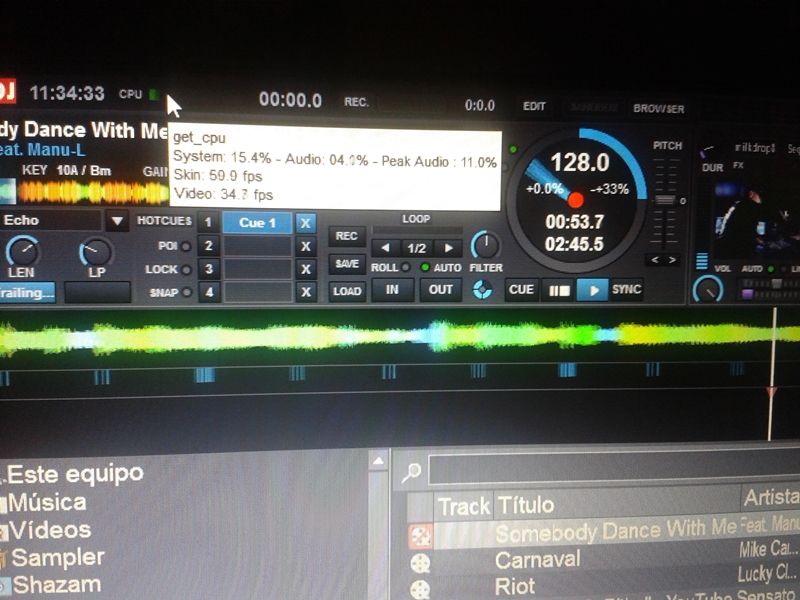

dedicated Nvidia GT540 graphics to activate video
Intel HD3000 integrated graphics
Intel HD3000 integrated graphics, audio only
Intel HD3000 integrated graphics, activating video
I would like to solve this problem, it is frustrating the sudden movement of the skin
Posted Tue 26 Jan 16 @ 2:54 am

If it would indeed be a swamp, you would be able to tell that you got stuck or something like that.
In this case it looks like the swamp has asphalt flat roads however, as you are getting a stable 30fps with the smart.
It is indeed still interesting to find out why performance is worse with the dedicated card though.
Can you try to set videoForceFullScreen to -1 ?
