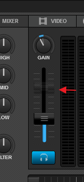

Did you notice if there was a "Ghost" Volume fader moving on the skin ? Like this...
Any other controls that were not working on the mixer or the deck or was it just the Volume fader ? Were you able to start/stop the deck from the controller ?

No I did not notice the ghost volume fader, and yes I was able to control stop and play from the controller
