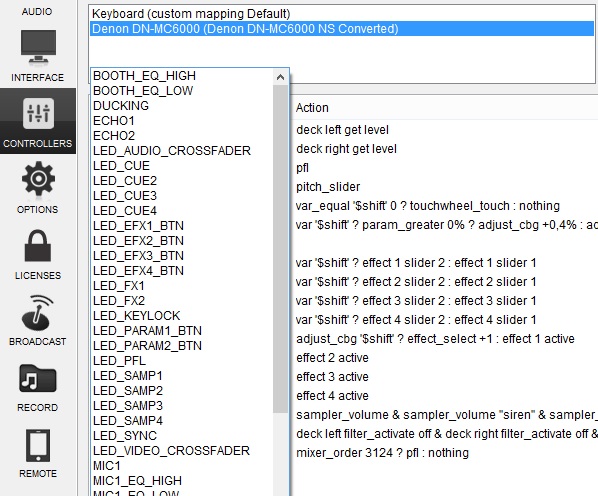

Is there a list of ACTIONS available to customize the specific LED colors of MC6000? The Key is listed, but can't find actions

You might be right, but, I am able to control on and off. So, I thought red and blue could be changed as well.

Yes... there is no option for deckchg
But, there are options listed for most of the rest LEDs as show.
Would like to know how to dim and blink....so on

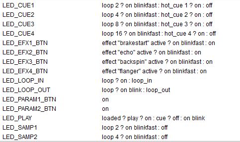

Ah, OK .... I thought you wanted to change the colour of them.
Not sure if you can dim but you can make them blink (also with a specified time in ms (blink 200ms)
See below from my MC6000 mapping:
