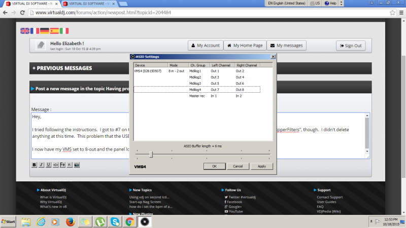

I now have my VMS set to 8-out and the panel looks like this:
Also I lost my headphones so now I definitely can't hear anything regardless. _._ I'll be back when I get some new ones. Thanks for all your help!

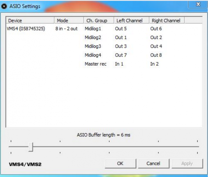

Custom skin on the VMS follows the 3-1-2-4 Deck order.
To assing the decks correctly to your midi logs, please set up your asio settings like shown on the screenshot:
