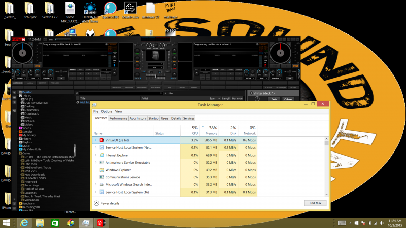

Your machine might have some more balls then mine because without any tracks loaded, no fx's on, no hardware hooked up, nothing just sitting idle VDJ still runs at just under 600mb
And memory usage only goes waaay up when I play the vdjedit. Ill quit using VDJ for making edits and just go back to making my edits with iMovie for simple stuff.

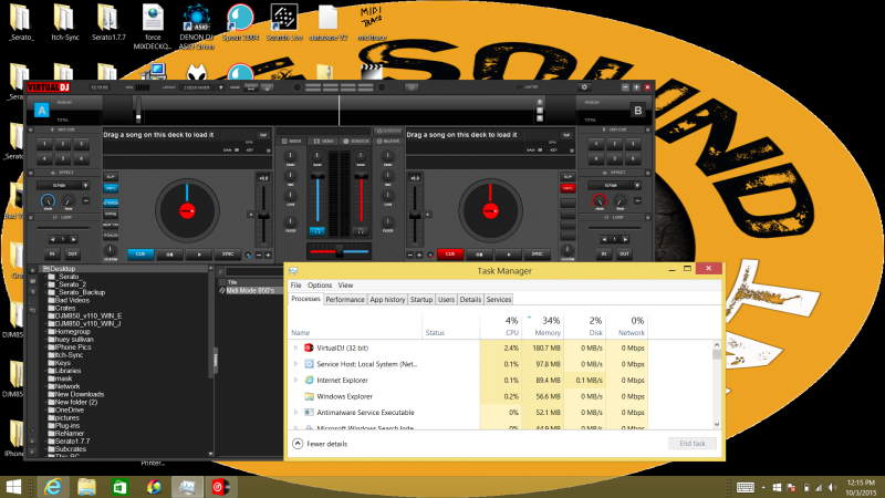

Mine runs at 599mb idle with the same skin - default skin idle I'm at 178mb huge difference
I'm sure the skin has an impact on memory usage as u can see from above.

You are correct Wicked,
Man that is a huge difference!! Holy crap!!
So I guess its either deal with the high memory usage or get used to the standard skin that has such a waste of space and is just plain ugly............ Well on to the next problem I guess.

I think the other topic you opened explains the high memory usage.
The skin as you noticed uses already 600MB, but on top of that you forced videoMaxMemory to 1950 instead of leaving it on default.
The Intel video card does not have much dedicated video memory, so it will continue using system memory.
Was there any specific problem you had that was fixed by changing videoMaxMemory?
Otherwise I'd strongly recommend leaving it at Automatic.

By default it should show "Automatic (xxx)" with xxx the detected value.
Remove the current value of 1950, then press enter and restart and you should see it say Automatic.
