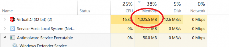

Ok how high is the number circled in this pic supposed to be or get??
Ive seen that number get as high as 3500 with ZERO hardware hooked up, not even an external drive.

If it gets as high as 3500 MB it is indeed a signal for a memory leak.
There should be a bug fix for this kind of leak in the last build.
But if the leak is caused by a third party plugin, there is not much Atomix can do.

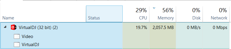

@ beatbreaker, could it be that you have 2 VDJ's running at the same time, on your screenshot it shows (2) behind VDJ, on my pc it doesn't.
maybe a stupid question, if so I'm sorry, but sometime it's hard to see the wood for the trees
Posted Tue 29 Sep 15 @ 8:01 pm
One is for the VDJ GUI and the other is VDJ's video output
