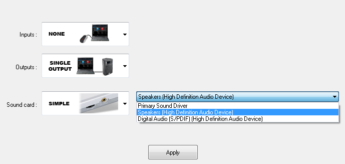

Also, can you post a screenshot of your sound settings?

My sound settings as they are right now:
I reinstalled VDJ to see if it did anything different, so I don't remember what sound settings I had before (the same, I think). For some reason, mappings remain the same, and both CUE leds do nothing, along with the Cue Mix (although Cue Volume changes cue mix knob, but with no effect whatsoever when recording). I have been using a mapping file for my Mixtrack Pro 2 because it wasn't being recognized at first, and I don't remember where I first found that file. It's possible that the mappings on this file are messed up.

There is the issue. You don't have the sound mapped properly. I would also use the default mapper, it is a natively supported device.
I also don't see the Mixtrack as an option. Did you have it plugged in when you did the screen shot?
Have a look here:
http://www.virtualdj.com/wiki/MixTrack%20Pro.html
With my controller plugged in, one of the sound card options is Speakers (3 - Mixtrack Pro II) [Simple], but I also have the option of selecting Numark instead of Simple. How do these sound settings affect the mapping, though? Because even when I change the mapping for CUE_MIX to have it in the way you see in the attached file, the CUE MIX knob still does nothing, and the CUE GAIN knob controls the CUE knob on VDJ.
What am I doing wrong?
