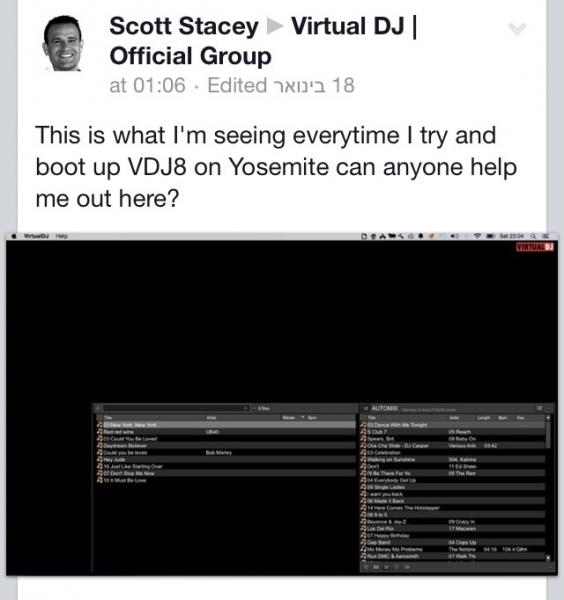

Could you point us to the link of the custom skin or email me the skin if its not uploaded ? (babis@virtualdj.com)
Btw, you said others mentioned skin issues with the latest build. Which are those exactly ?
Posted Sat 24 Jan 15 @ 4:16 pm

so windows and mac, same issues? skin not really rendering somehow? custom skin? or default skin?
Posted Sun 25 Jan 15 @ 1:51 am

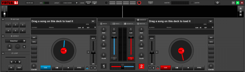

Couldn't that be related to the issue I mentioned about the drawing of some vu-meters in my skin ? Looks like a layering mistake in both cases...

I've had this problem with the skin for a long time now.
I'm using the SP1 skin and the deck controls don't show up, I press the deck 3 and 4 button on my controller then everything goes back to normal.
Wasn't a big or at least I didn't think so but yes this has been happening for a while now......
