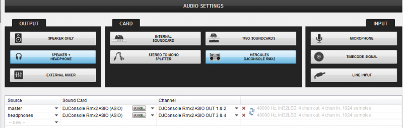

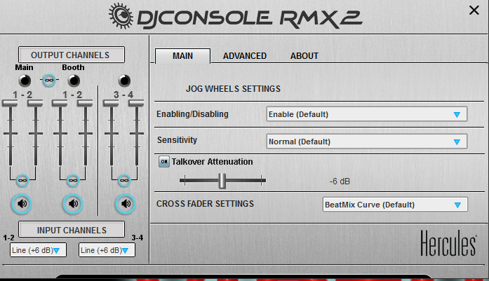

I use this config, and don't have that issue. The mic is hot, even with the attenuation all the way down, but it works. Remove the mic configuration from the audio setup, and see how that sounds.
I also use the talk over

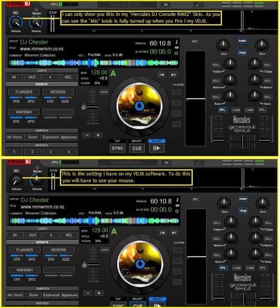

following are the equipment that i use & HAD a similar issue: Hercules RMX2, Virtual DJ8, Shure BLX Wireless mic & Mac book pro.
Solution that works fine for me:
Now i use the "Hercules DJ Console RMX2" Skin. Now when i fire up my VDJ8 Software i have noticed that the default Microphone setting is tuned up to the max/ full [As indicated by the blue dotted ring] Using the mouse i turn the volume down completely , this will now not show you the blue dotted ring.
Now on the physical Hercules RMX2 mixer unit i make sure that the volume knob is also turned fully off & the mic button is switched off.
Now i connect my microphone cable [regardless un/balanced cable]
Now i press the mic button on & very slowly turn the physical knob on the mixer while doing a voice test on the mic.
NOTE: What i have noticed is the Mic know on the mixer has to be barely turned up [almost close to zero] and the mic to work fine, there us no Hissing or anything. By the way the Mic volume on the physical mixer is not connected to the software volume on the VDJ8 software. So you will not see it go up or down like the gain on the Mixer & VDJ8 software works.
I hope this helps you out........ If you are still having issues send me a PM
