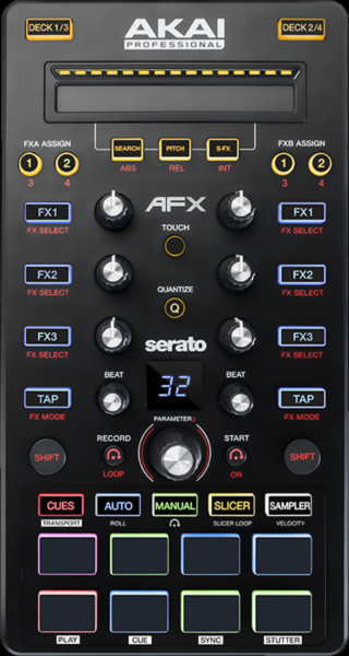

As of builds ending at .896 (or higher), AKAI AFX is officially supported in VirtualDJ 8.
Product page : http://www.akaipro.com/product/afx
VirtualDJ 8 Operation Manual : http://www.virtualdj.com/documents/AKAI%20AFX%20-%20VirtualDJ%208%20Operation%20Guide.pdf

I have just purchased an AMX and two AFX controllers. I have been a Traktor S4 user for years but the release of the S8 indicates to me that Native Instruments have no intention of introducing flexible beatgrids so I decided to move to Serato DJ. Unfortunately SDJ doesn't have a prelisten feature which is critical to my workflow. I have read through the Virtual DJ Operations Manuals for these controllers and can't see a way to prelisten to tracks using the browse knob on the AMX.
I see that Virtual DJ has both prelisten and flexible beatgrids so this is my last resort for this hardware. Can someone please let me know if it is possible to do the following:
Map the browse button on the AMX to play the selected track through the headphones when clicked and rotating it left/right scrubs through the track. If it is not possible I will return the hardware for a refund. If it is I will happily pay $299 for VirtualDJ 8 Pro Infinity.

Which unit do you have ? AMX has a built in soundcard. AFX doesn't.
