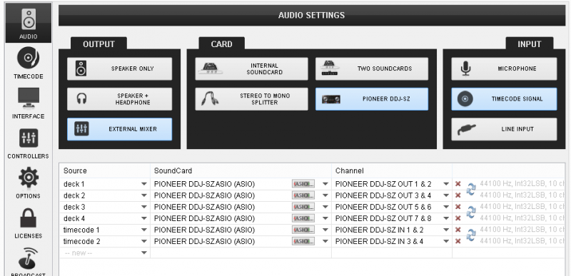

Ok everything works great here.
Here is what i set TC up.. but can differ of course...
- Cd players connected to Inputs CH1 and CH2 at the rear side of the DDJ-SZ

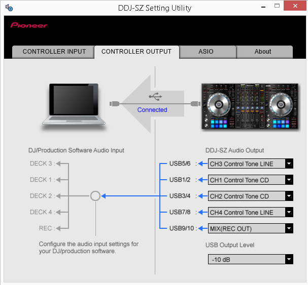

Pioneer Utility Outputs set like this...
Notice that CH1 and CH2 (used in my case) are USB CH1,2 and USB CH3,4 for Pioneer sound card so you need to use the same Channels in the Audio Setup of VirtualDJ
In my case i had

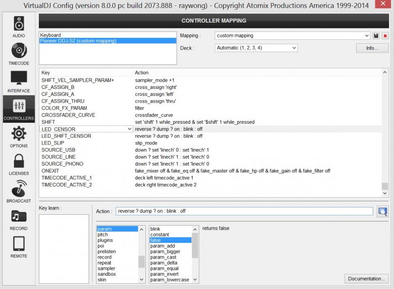

Now the most important part is how you enable the Timecode inputs if you want to use the left Timecode input to control the left decks (1 and 3) and the right Timecode Input to control the right decks (2 and 4) whenever you switch those using the DDJ-SZ swap buttons.
You need to turn off all TC buttons from the SCRATCH panel and create 2 new Custom buttons like..
deck left timecode_active 1
and
deck right timecode_active 2
Press them once to turn them on.
You re ready.
If you need to use Turntables then you will need to use the CH3 and CH4 at the rear side, and make sure the USB 5,6 and USB 7.8 from the Pioneer Utitltiy are set to PHONO (not LINE)
Then in Audio Setup of VirtualDJ, Timecodes a1 and 2 need to be assigned to Chans 5,6 and 7,8

At long last finally have all my issues resolved and working 100%. Opposed to what you suggested, this is what worked for me.
deck 3 timecode_active 1 & deck 4 timecode_active 2
Also I uninstalled the app & settings, recreated them and now my jogwheel display functioning correctly for decks 1&2.

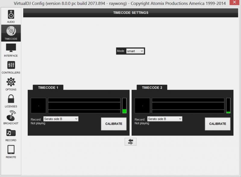

Please take a look here.. http://www.virtualdj.com/manuals/hardware/pioneer/ddjsz/dvs.html
Post screenshots from your own settings (Pioneer Utility ,Audio setup and Timecode tab of VirtualDJ Settings) to see what you are trying to do.

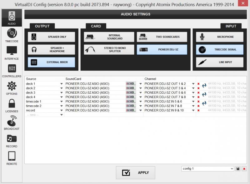

okay ill try and post some screen shots. but as i see it i have the right things.
Posted Thu 13 Jul 17 @ 6:08 pm
must be doing something wrong here
Posted Thu 13 Jul 17 @ 6:28 pm
Posted Thu 13 Jul 17 @ 6:29 pm
seems like my pictures wont show up
Posted Thu 13 Jul 17 @ 6:31 pm
my pictures is not uploading i guess.
Posted Thu 13 Jul 17 @ 6:36 pm
the only place i can see is diffrent from the guide. is the custon button, but is this vital for a turntable to function?
