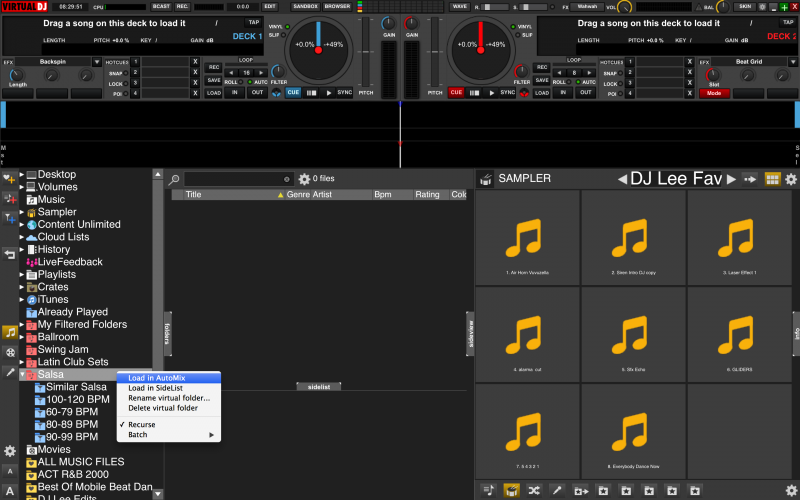

With some folders, the Recurse function seems to have stopped working. Especially if the folder has Filtered folder nested inside. See the picture. I swear I used to be able to recurse this folder but not since Build 2031.
I've tried with a few other folders and some recurse and other don't.
Using a Macbook Pro with Retina

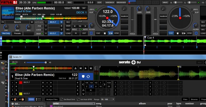

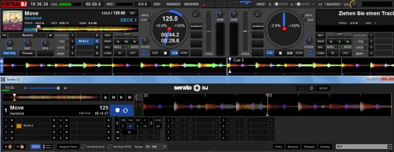

The Serato HotCue Import is not exact enough.
The timecode seems to be correct (44.2) but the position inside the waveform is not 'on the beat' as in SDJ
look:
Same with another Song:
look:
Posted Sat 15 Nov 14 @ 12:47 pm
What format is the file?
Posted Sat 15 Nov 14 @ 6:02 pm
mp3 (cbr)
