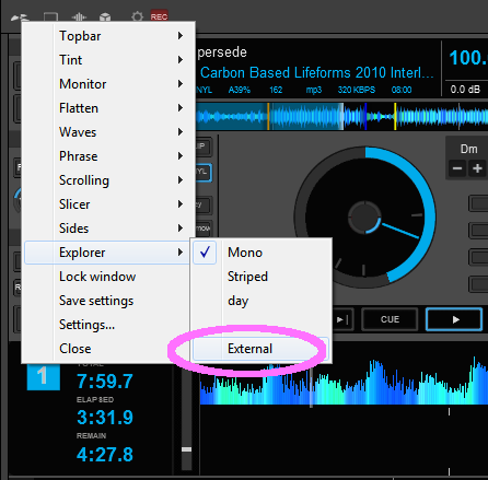

Fruit wrote :
It might be the external browser window. You can check this by clicking the menu atomix / explorer / external.
External windows are still bugging a lot with OSX.
Thanks but i looked on VDJ how do i get to that menu your talking about?
Posted Mon 23 Jan 17 @ 11:41 pm
![](/img/220218/18405/v0.7-external-01.png)
Posted Wed 25 Jan 17 @ 10:10 am
ahhhh ok got ya mine was a blinking triangle. Thanks. tried it still white box when i shrink the fruit skin.
Posted Thu 26 Jan 17 @ 2:28 am
But when you trigger that menu, does the external browser pop out ?
If yes, does it replace that white window ?
If no, what happens if you trigger the menu several times ?
What is your OSX's name / build number ?

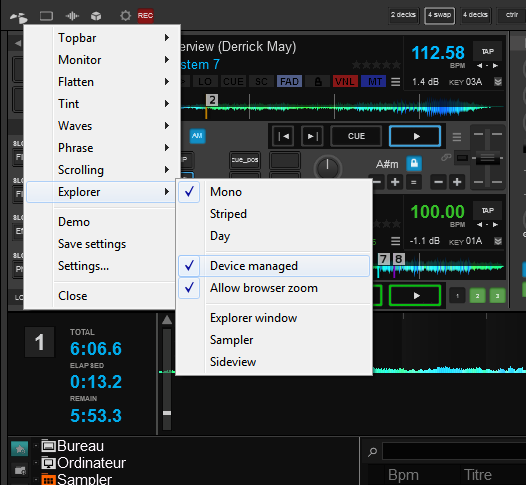

It's an intended behavior, to let you browse files with great room.
You can disable this by unchecking : atomix / explorer / device managed
No need for a video ^^

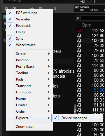

Also, the controller layout can behave separately from the other layouts :

yes I tried those options, nothing happens...
edit: thats it! the 2nd image. thank you Fruit!

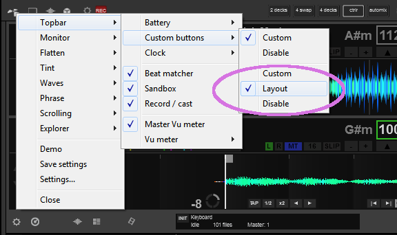

You might also now find some topbar buttons to easily achieve this task :
