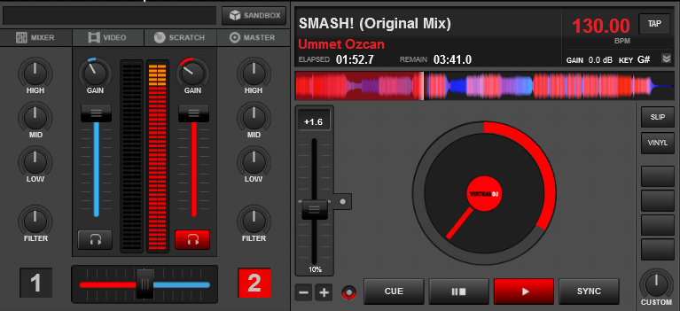

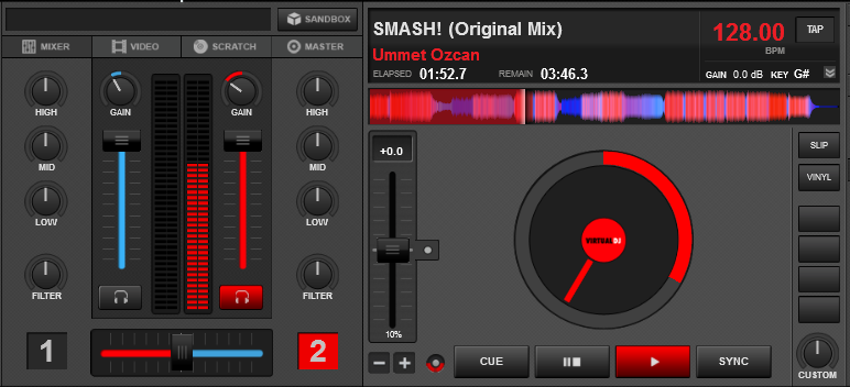

Probably I noticed it just now, look at the gain level in 128 bpm and in 130, This of course also affects the master.
128bpm
130bpm
128bpm

Yes as pitch increases so to does volume, it is the same deal with key, key goes up so does volume, not sure if it could be called a bug (try turning master tempo off) but it's certainly something I'd rather the machine dealt with, but Auto+remember gain adds some coding difficulty, unless key/pitch change changed gain in a temporary way.

Locodog Are you serious ? Its only 2bpm up not 10... The difference in the gain level is too high for 2bpm, in every day playing you add 2-6 bpm So in every tempo change the sound will be distorted ?

i tried testing what dj swid showed us above and i couldn't get those same results.
mine came out pretty much the same volume.
maybe its a setting causing it my
keylock is off
pitchquality is 1
autogain is auto
not sure what you have things set to but i'm not seeing this increase in volume.
keylock is off
pitchquality is 1
autogain is auto

MT is on
Auto+remember
Pitch Quality is on 1
I7 2.2ghz 8gb samsung win 7
Auto+remember

@Dj Swird
I think the answer is much more easier. If you rise or slow down speed, than lenght of song changes. So that what you show on your pictures is not exactly same part of song. You have to make mesure on CUE point.
Sorry for my english, i hope you understand.
Regards Tomas.
Regards Tomas.

Tjeck1972 wrote :
@Dj Swird
Regards Tomas.
Regards Tomas.
It's not abouth length, the problem is the volume
Posted Fri 29 Aug 14 @ 10:36 am
I checked, there is a problem with the Master Tempo that causes that, I am 8 years Always working with it with no problems like that.
Tjeck1972 wrote :
@Dj Swird
Regards Tomas.
Regards Tomas.
Diferent position in song = diferent output level. Pictures above do not show anything.
Posted Fri 29 Aug 14 @ 11:45 am
Not by that much!
You can see by the waveform that it's the same area of the track and there are no wild level differences - yet the meter shows a huge difference.
Posted Fri 29 Aug 14 @ 11:54 am
