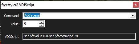

Hi Scott,
For some reason the only command I can generate with the freestyler8 VDJScript is "Add scene" Any idea?
Posted Sat 24 Dec 16 @ 11:31 am
