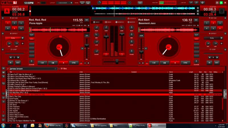

Hi skin fans!
After my recent dabble with skinning by making a blue version of Dan's Browser Zoom skin, I have now gone all Native American.
Gentlemen, I present to you.......the Redskin. :-)
As you can see, I have managed to eliminate almost every aspect of the traditional Atomix "left is blue" colour scheme.
However, I'm not sure it's possible to make both large waveforms the same colour. Anyone?

Of course it is possible.
IMO, the waveform is the only one widget that should still different colors, cause both are 'mixed' in the same area.
Maybe with two VERY DIFFERENT reds... You should have a try, keeping in mind that it is important to not confuse them.

This is the reason I have chosen the "one above the other" view instead of having them superimposed.
Posted Fri 11 Jul 14 @ 7:20 am

OK so I have been through the XML many times, looking for the source of the colours for the horizontal scratch waves - and I can't find them.
I have changed every reference to colours for waveforms that I could find, but they still show blue & red with gradients for frequency.
The other wave choices have changed, but not the ones you can see in the picture (horizontal scratch wave).
I am stumped.
Posted Fri 11 Jul 14 @ 8:26 am
I think they use the same as the songpos when the waveform is set to monochrome or per deck.
Posted Fri 11 Jul 14 @ 8:36 am
I've changed the songpos colours. I'm only using songpos red, but even changed the colours on the others just to make sure. No joy.
Posted Fri 11 Jul 14 @ 8:46 am
FruitPRO InfinityMember since 2003
I think the only solution for scratchwaves is to tweak the mask's color in the png file.
Another solution is to put a semi-transparent colored visual in front of the waves.
Check in my skin how I handled to have a 'dimmed scratchwave' on decks's screens.
Posted Fri 11 Jul 14 @ 9:01 am
I'll have a look later. It was possible in Beta but maybe it's changed.
Fruits options will work though, but I don't think they are exactly what you want.
Posted Fri 11 Jul 14 @ 10:41 am
You can't alter the colours of scratchzones.
In monochrome they use the "per-deck" sceme
On all other waveform color settings they comply
So, to achieve what you want you must use 'infra-red' color setting for the waveforms
Posted Fri 11 Jul 14 @ 11:15 am
I'm a beginner - where do I need to state that?
Posted Fri 11 Jul 14 @ 12:13 pm
I see in your screenshot that you have set the 'infra-red' waves already.
Posted Fri 11 Jul 14 @ 12:22 pm
On the options inside config
Nope.
He used monochrome and set both waves same colors
Posted Fri 11 Jul 14 @ 12:42 pm
Oups, I beg your pardon my dear.
Posted Fri 11 Jul 14 @ 1:18 pm
Ah, nothing to do with the skin files. OK!
Hmmm, now it looks pink.
It seems that monochrome only really affects the songpos wave. The rhythmzone ones stay coloured.
The other choices affect all waves.
In the skin, we can change the colours assigned to freqs. Why only in the skins?
Posted Fri 11 Jul 14 @ 1:48 pm
