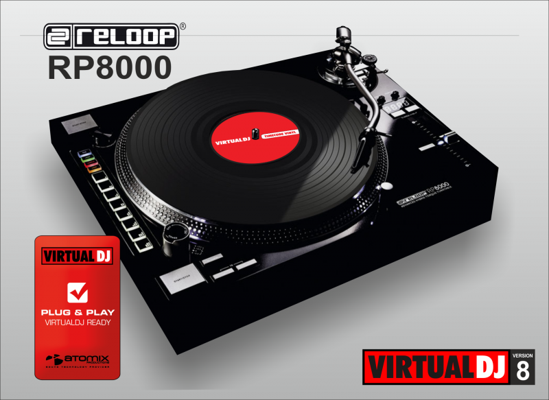

Reloop RP-8000 is now natively supported in version 8.
Just make sure you are running a software build that ends at .694 or higher (let the software run idle for a few minutes in order to silently update the controllers.dat file and relaunch)
We will provide a pdf file with the assigned actions, but here is a brief description..
CUES mode
Hotcues 1 to 8
Holding down the CUES mode button and pressing the 8 Pads, delete the Hotcues
LOOP mode
Loops from 16 beats to 1/8 beat
Holding down the LOOP mode button and pressing the 8 Pads, they perform a Loop Roll from 4 beats to 1/32 beats
SAMPLER mode
Sample trigger from slot 1 to 8
Holding down the SAMPLER mode button and pressing the 8 Pads, they behave as following...
- Pads 1 & 2, change the bank -1/+1
- Pads 3 & 4, change the Sample mode (select previous and next trigger mode)
- Pads 5 & 6, half or double the Loop of the selected/triggered sample
- Pad 7, empty
- Pad 8, record sample
USER mode
Slicer buttons 1 to 8
Holding down the USER mode button and pressing the 8 Pads, they trigger slicer 'hold', meaning that the triggered slice is memorized.
Note that the unit offers MIDI notes for almost all the buttons, sliders, knobs, but we only mapped the BROWSE encoder (and push) to navigate through files and load to the deck. It really makes no sense to map the pitch slider, the play button etc, as the main use of these devices is for Timecode Vinyls.
All these extra buttons and sliders are pre-defined, but not assigned in the factory default mapping
Big Thanks to Arnoldo for his cooperation
