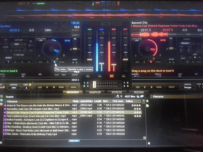

Same behavior. Decks 1 and 2 are recognized, but in the pic, BOTH decks are playing to the Master, even though the crossfader is pushed left. I've made no changes to the "factory" ONINIT mapping line, since it appears 3124 is actually what I want. Using the new ASIO driver with "Headphones" and Master: 1/2 + Headphones 3/4.
