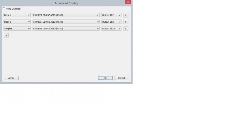

my config in 7.4
I understand why the auto gain in V8 is not working with my DDJ-SZ. Automix is also very bad when you have video's or songs with different volumes.
My settings are always set to Auto, but this is not working for me. You see the volume correction only on the screen, but the volume on the SZ does not.
But why does it work almost perfect in 7.4? As far as I can see is in 7.4 only the crossfader fake, because if I move the faders on the screen the sound volume is also changing. I think this is a far more better solution. The only bad thing in 7.4 is that we can't link the video crossfader with the audio crossfader.
my config in 7.4

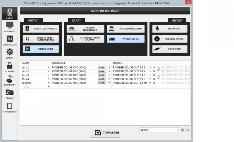

my audio config for VDJ8
