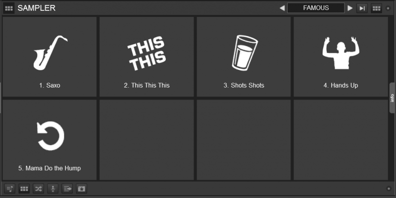

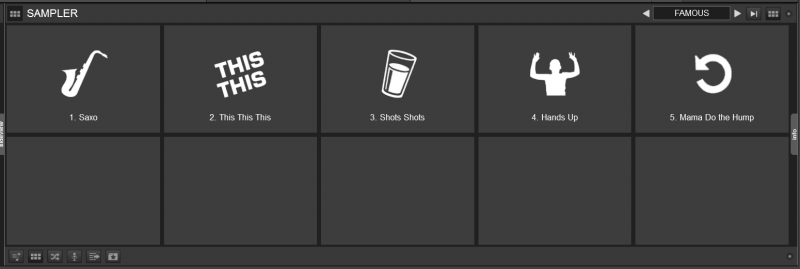

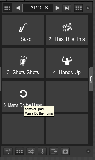

OK I'm using the VDJ 8 Fullscreen Browser skin on a 1920x1080 monitor.
I have the 'famous' sample bank loaded, so the first 4 slots are saxo, this, shots and hands up.
On pad 5 I have a loop I recorded from Mama Do The Hump. The sideview is open so that I see the pads in a 2 wide by 4 deep config.
Set like that, pad 5 is below pad 3 (shots). If I then drag the sideview bar left, the pads move to a 3x3 grid, then 4x2.
Keep pulling the sidebar left. Eventually it'll switch to 5x2 and the sample labelled 5 will jump right, over to pad 10 and rename itself 10.
Posted Sat 31 May 14 @ 7:24 pm

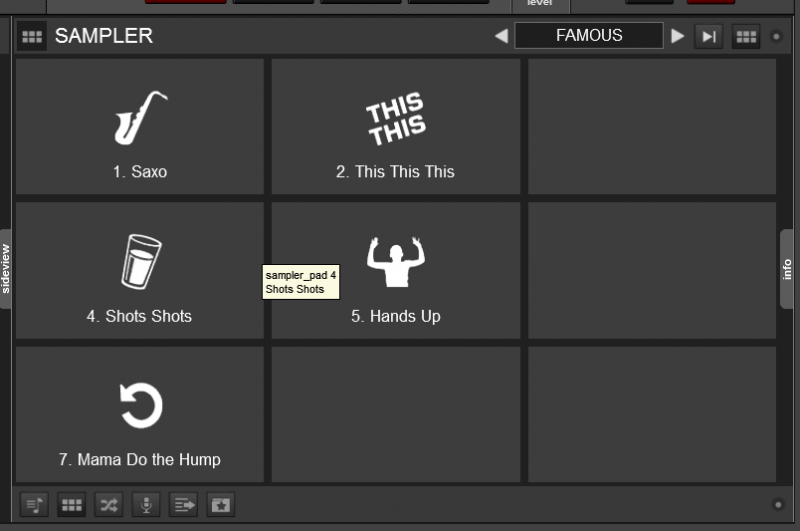

Ok well i was able to re-produce something similar but not identical. When i got the 5x2 it was ok - but at 3x3 it was wrong.
Will report though - thanks guys.
Posted Sat 31 May 14 @ 7:32 pm
Even weirder that it's not consistent. You've actually got three in the wrong place in that 2nd pic!

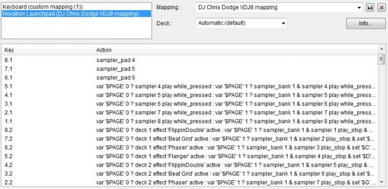

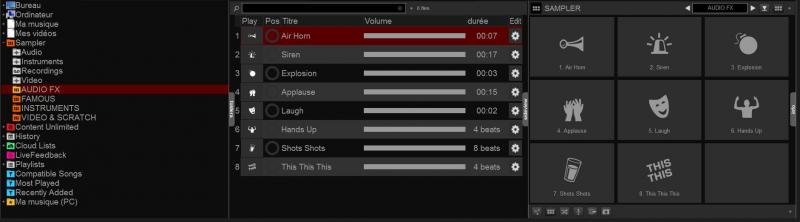

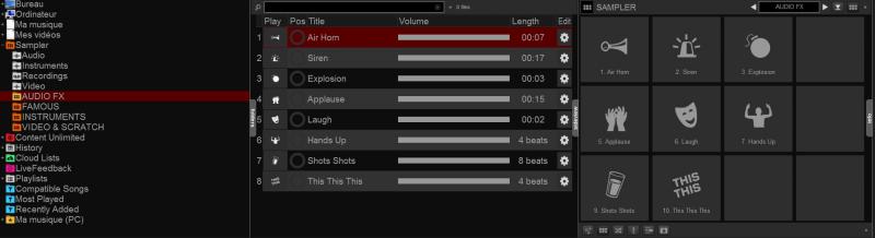

I uninstalled then reinstalled VDJ8
Then I added some samples in the AUDIO FX bank (I took origin samples that I moved)
Here a screen :
here the keyboard mapping for the sample 4, 5 and 6
and the Novation Launchpad mapping :
you can see that is exactly the same script, but with the Launchad it don't work !

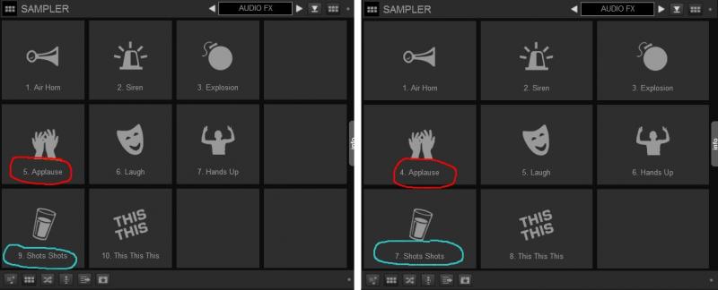

SuperAceMan thank you for this idea, it prompted me to look further. If I change the pad layout and select 4 columns, I have that :
you can see that the samples have changed their number!!
Here a screen :

@Dodge57
your problem is inside at definition of controllerPad
Posted Wed 02 Jul 14 @ 6:08 am
no Bazzooka, I don't think so. I fully mapped my launchpad on the V7 as the V8 and everything works perfectly except the samples.
Especially now that Launchpad is a native in VDJ8, therefore no device file.
In addition you can see here that another member has the same problem on an Akai APC40 (post of Tue 01 Jul 14 @ 7:35 pm)
Then the controller does not explain the changes in numbers of samples on VD8 !
(sorry for my english)
Posted Wed 02 Jul 14 @ 8:42 am
