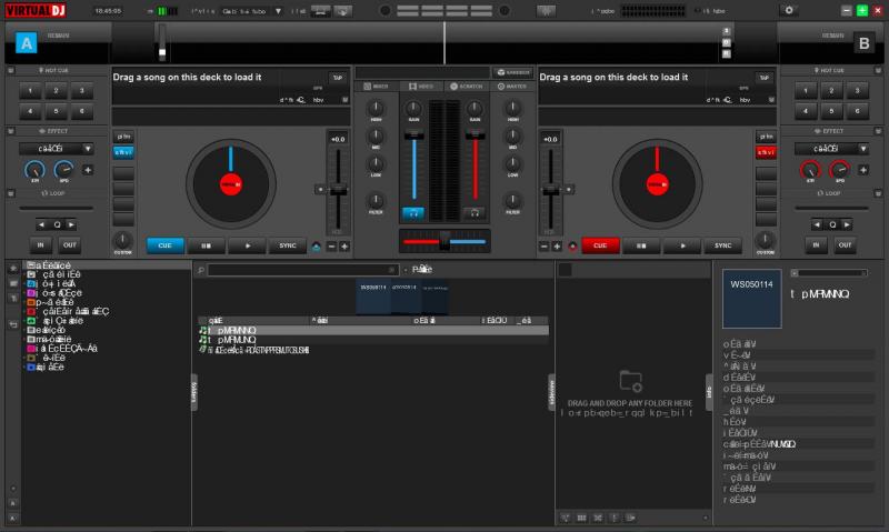

I have just installed the Home version of VDJ8 and something very strange has happened to my display
![](/image/34700/137268/10317648_10152051370101260_2018399988556174702_o.jpg)
Can someone please explain to me why the display is all in gibberish? How can I solve this problem? Many thanks in advance.

Can you check what language is selected in Config->Options ?
EDIt, hmm it seems that its not language related. Something is wrong with the fonts in your computer.
By default the 2 deck skin uses the Helvetica font , and if not available it would use the Arial. It seems that its not the case in your computer. Do you have an Helvetica font installed and if you do, can you properly type with it using a different application ?

I don't think I have Helvetica installed, but I almost certainly have Arial installed. This seems very strange because I also have VDJ7 installed on don't have this problem?

Could you try with a different skin, e.g. the VirtualDJ 7 one ? Or is the issue not related to which skin is selected ?

Changing the skin hasn't made any difference I'm afraid.
