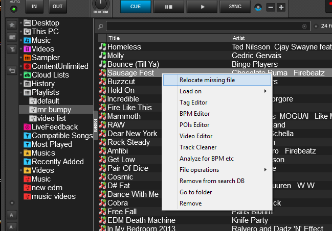

when it says Browsing..it probably means that it tries to relocate missing tracks or rather broken links. VirtualDJ 8 is not "fixing" any links though, so it tries to do that each time you browse through your Playlists.
The most common reason of broken llinks of Playlists is the different letter that an External Drive can get and of course because you have moved the tracks to a different location or even renamed them.
I would still suggest to manually check and edit the paths of your Playlists , either by opening them with a Text Editor or even use the Playlists fixer (tool from the Plugins Page)

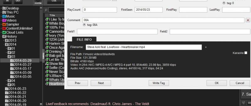

file info I had added was gone from tags as well but filepath was unchanged.

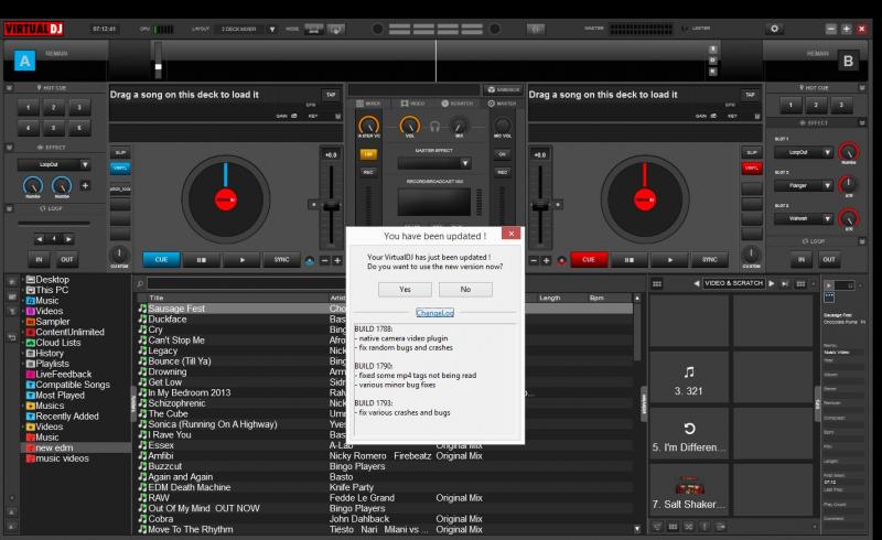

told vdj to rescan folders again, got on the exercise bike and watched a movie, sat down to play with video again - it crashed trying to use a text plug in (text2d -yeah I know I keep forgetting they aren't ready) - and now they are back to not being read.
