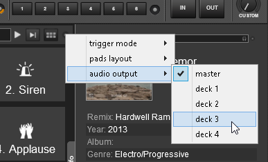

Is there any way to get channel 3 to be the sampler volume using the N4?
Posted Thu 22 May 14 @ 6:31 pm
Starting from Sampler_Options button on the top of the Sampler view ...
Posted Thu 22 May 14 @ 7:18 pm
