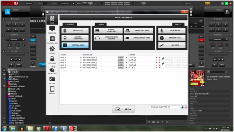

Have a look at the screenshot of djsherz...think it is the best setting for VMS 4.1
Also keep in Mind the the 4.1 has got a analoge mixer so you cannot record your set by using the internal recording function of vdj.
as babis said, you should either use the record loopback and get e.g. the booth out connected back to you pc system and use a external software like audacity to record.
another way for easy recording is to use an external recording device like the reloop mixtape, which works actually pretty good....
