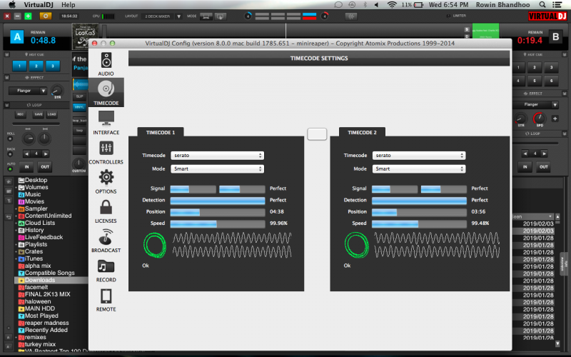

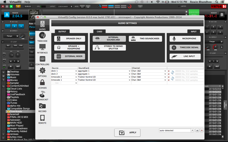

hello dear TIMECODE GURUS!!! lool i am still struggling to use the tractor z2 with time codes i have already created a quadraphonic sound card and made sure that it is the same bit rate /sample rate etc. but once i plus in the correct input information in vdj8 . the closest thing i can get is 1 timecode working and the other is silent. and all the sounds come out of 1 channel ..its not separated. is it because i have a z2 ?? thank you in advance
Picture of the sound setup screen with it setup how you think it should be. Id imagine its probably like the DJM T1 which I have so Ill compare the 2.
this is the most i have been able to get it ..
still messing around with the audio setup ...btw how many aggregate device do i need to create ?
Why are you creating aggregate devices?? it should just be
deck1 TKZ2 ch1/2
deck2 TKZ2 ch3/4
timecode1 TKZ2 ch1/2
timecode2 TKZ2 ch3/4
So delete the aggregate devices and try it my way. Then post back and let me know what happens.
