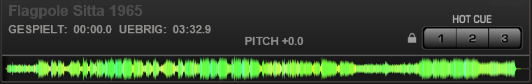

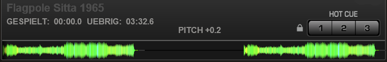

Oh, and one more question: Sometimes tracks are loaded in a weird way, as it seems also influenced by the timecode - does anyone else get this am I doing something wrong?
Same file, different parts shown:
actual track
weird fragments
the fragment is probably just busy pc, and vdj waits to fill up to the pc is more ready for it.. It fills up eventually right?
- Nope, just stays that way (at the event the pic shows even when loading another track and then reloading the fragmented one - had to restart VDJ, or at least did not find another solution for that). If you look closely, it's the last part of the file copied to the front with a big gap in between.

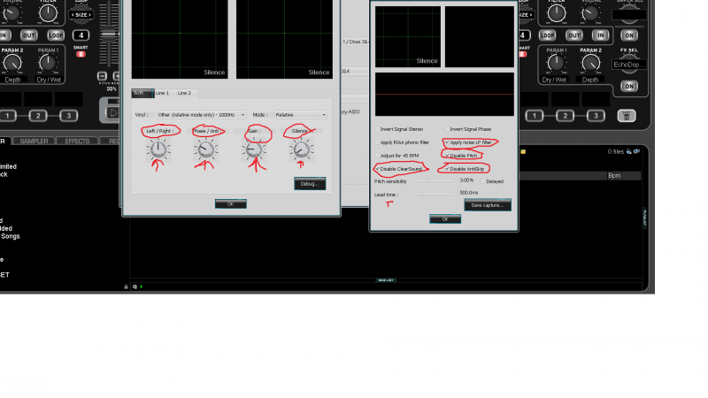

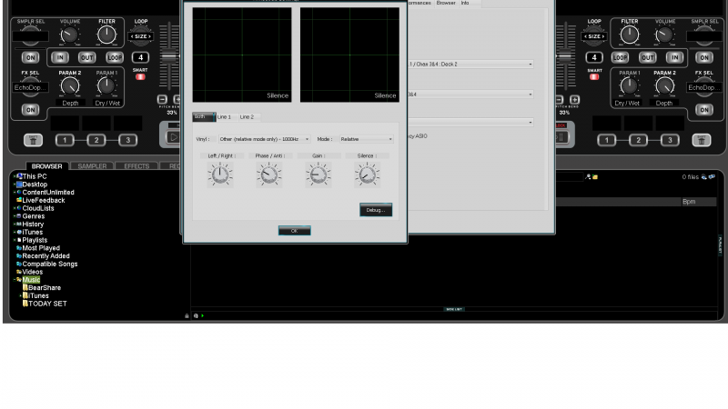

these setting the 1 in the pictures so u can adjust the way u want it i like to battle scratch and beat juggle as well. i can do all this with serato i could not do this with vdj 7 .and i love virtual dj 7 but some stuff i could not do with it. so in vdj 8 i will like to get it right so when i go on line to try to enter for the d.m.c or the red bull comp i will like to switch it up with virtual dj 8 and show what it can do with it.and try to shut all the serato user down because before i will use virtual dj 7 and alot of serato user look at me like i was some amateur and i do alot of club here in new york city and they all have serato so i was stuck using it but in my private party and dj on virtual dj radio i use vdj 7 i love it. so with vdj 8
i will like to take it to the clubs and party and show them what it can do and on the comp.be the first 1 to us vdj 8 and show them that serato and traktor are not the only software.

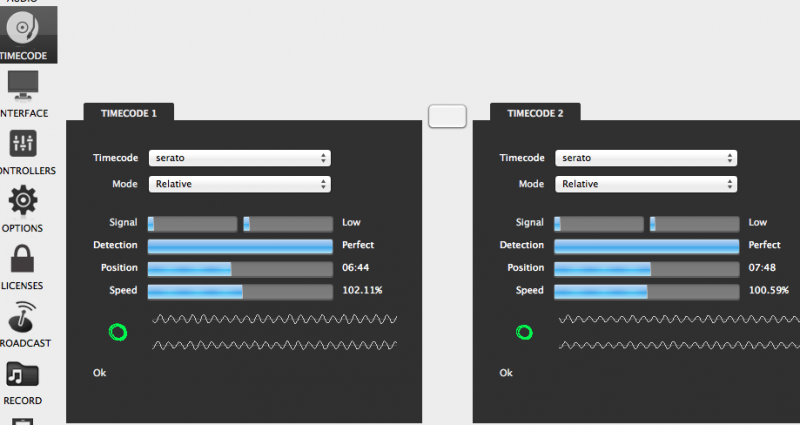

Mac mid 2012, i5, 4gb Mavericks..
Using a maya 44..
The timecode is super laggy.. Embarrassingly laggy.. I can move the record and it responds 3 seconds later.
I also have an sl1 but I think this is not compatible with vdj 8 on the Mac side...

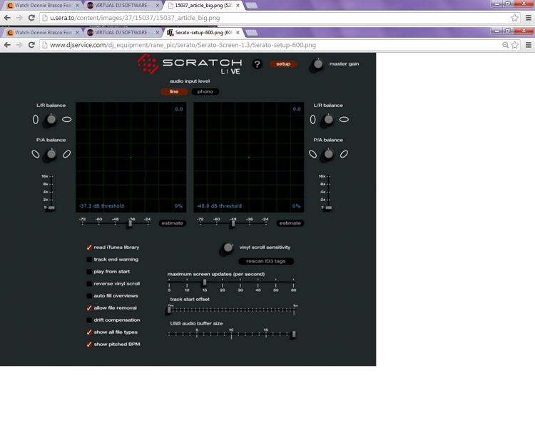

we need controls like this to set up timecode right this how it look like in serato
anybody know how to adjust the lead time so when u scratch from the beginning of the track the timecode, ensure that the start of your MP3 matches a position on your timecode from the start. In vdj 8 don't know how to do it .HELP
Basically the volume is too low which makes vd8 timecodes super laggy.
I tested in vdj 7 and had much better responsiveness because their is adjustable controls such as gain knob in the timecode settings..
As is, with this huge timecode flaw, vdj8 is not ready for final release..
Using a maya 44..
Can I ask wich cart you use?
I'm using the maya44 usb on win7 with shure's m44-7 (1200 mkII) & I have no problem with lag/latency
The same carts as you..
But like I said, I also tested on the same machine with vdj 7 and it works better than in vdj8..
I may post a vid here when I get sometime..
