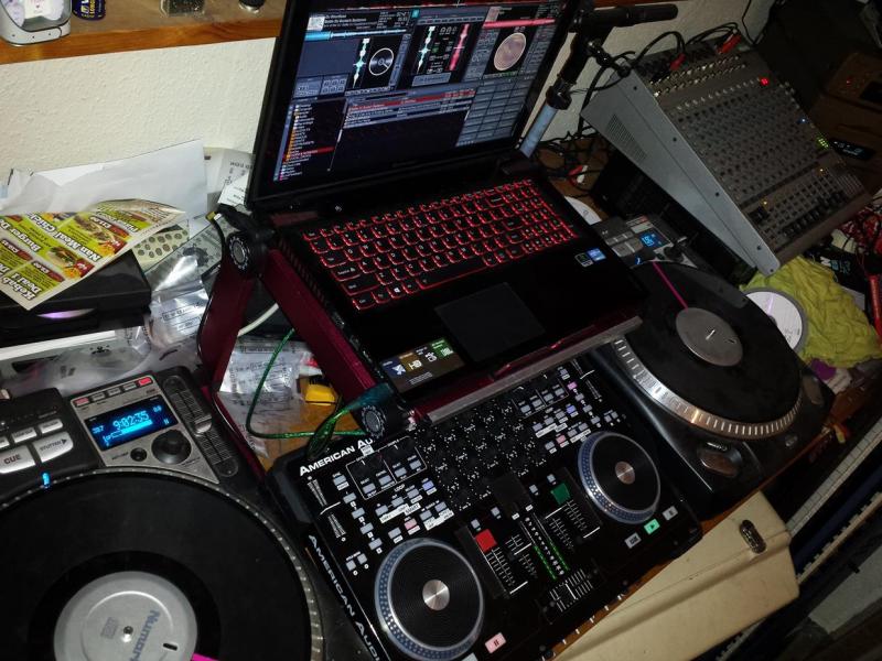

Just tried hooking my CD players up to my VMS4.1 for a little wicky-wicky session with the version 8 timecode. After a quick tweak of my soundcard's buffer settings, I've got to say it sounds great, and waaay more responsive than the old engine. Hats off to you clever coding people, reckon you've cracked it this time! :)
And yes... I know my desk is a mess.

@djsherz, glad to hear it's working good for you. The team has put in a lot of work on this.
You can tell, it's a whole other world away from the old timecode engine!
