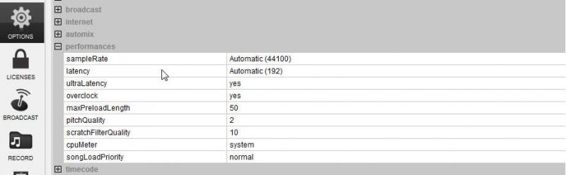

Ok you all this is my setup for now
Win 7pro 64bit
I5 3570k @ 3.4o
Ram 16
Hercules Deejay Trim 4&6 (ASIO)
Serato TCC
My setting look like this
Not sure why but the sound get really loud on back cues/spin backs
Is this your only problem?

Thats the only problem i have also..tho it seems minimal it affects the sound of the scratch unfavorably. But that is the only problem i notice. And i have my settings alot lower the what he posted i use 44100 without the automatic, and latency set at 64 without the automatic. I removed the automatic so it stays consistent without having to process for those fields.

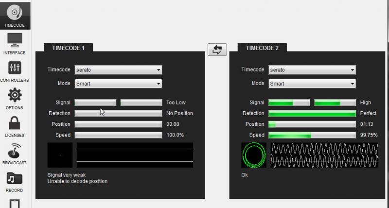

When I try to use my time codes I keep seeing that my signal is too high. How can I reduce the signal?

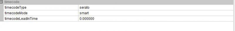

Did you choose "serato" in options - timecode?
You sure the Audio 8 isn't set to "phono"?
Yes.
its set for timecode vinyl. I dont see an option to select "phono" on the hardware. Would it be in the software that came with the audio 8? If it is I will give it a shot tonight when I get home.

It been a while since I've used an Audio 8 but I thought you could select line or phono in it's control panel. I know I can do this with SL3.
