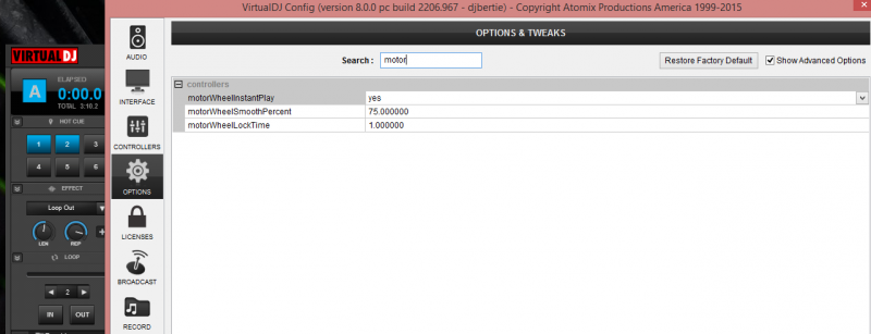

I have tested my S3700 again yesterday (I'm on Windows 8.1)
Platter takes less than a second in order to stop here and after that all functions are active.
Please open VirtualDj configuaration and click on OPTIONS icon on the left.
Make sure that "Show Advanaced Options" is checked and type "motor" on the searchbox
Post a screenshot here of the config page...
Posted Wed 22 Apr 15 @ 5:23 am
Posted Thu 23 Apr 15 @ 10:00 pm
