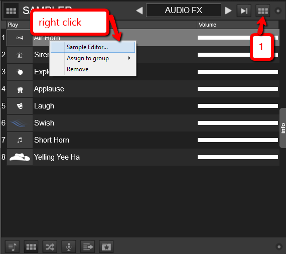

Adding new samples is easy!! ;)
You can drag and drop a file onto the sample bank - the use sampler editor to create the exact sample you want.
You can record from a deck, from the microphone or from the master output
Check out page 39 of the manual!!

thanks touch dan. How do i get the sampler editor? Also anything about the playlists yet
Posted Sun 11 May 14 @ 7:43 pm

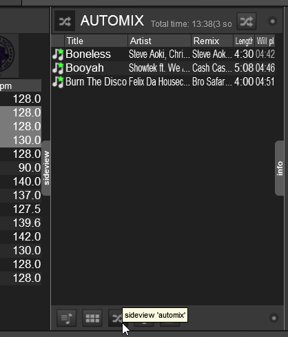

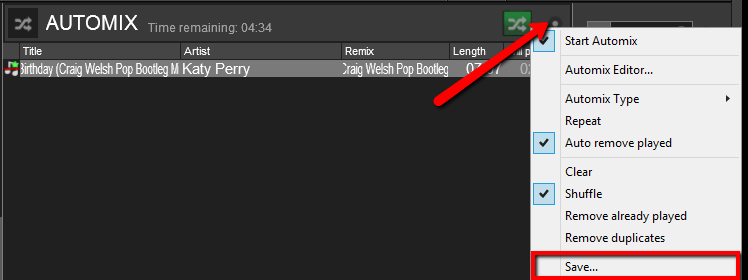

Use the automix panel in the sidelist. Create your playlist, order it as you like.
Then click on the button top left and then save. :)
Posted Sun 11 May 14 @ 8:38 pm
Actually its on the SIDEVIEW,
See also the Manual...page 49, but i am sure you wont have issues, as all the other Playlists features are similar to version 7
Posted Sun 11 May 14 @ 8:44 pm
