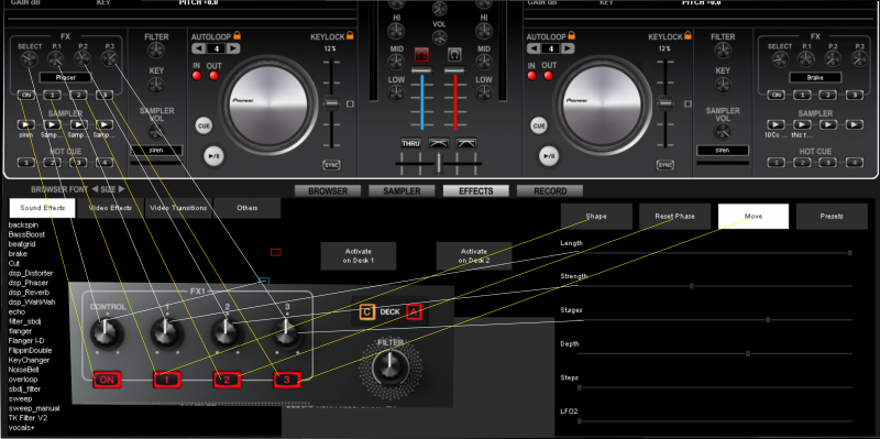

Lets first make sure that the controller is properly detected.
Open Device Manager (Control Panel->Hardware) and see if the unit is properly installed (no yellow triangle icon is present)
then download Home Free version (which will support the unit for 10 minutes each time you launch it), and see if the unit is listed in CONFIG-->Mappers tab as Pioneer DDJ-Ergo
Using the LE version, the Filter knobs should control the resonance filter of the software and should also turn the FILTER knob on the Pioneer DDJ-Ergo skin
On each FX section/side the knobs and the buttons below them, should follow the ones you see on the Ergo skin.
The 1st knob should select the effect and the other 3 knobs should control the effect parameters you see in the EFFECTS page of BROWSER (, IF available (not all effects have parameters
The 1st button below the 1st knob, should activate the selected effect.
the other 3 buttons should control the effect buttons you see in the EFFECTS page of BROWSER (If available)..not all effects have effect buttons

It's important to know which knobs work or not, so that we can assess the problem and help you.
In the case of the above, have you ensured that you have samples loaded into the relevant slots which are accessed by those buttons?
From what I can see in the mapping, the four buttons on the Deck A side play the first four sample slots, and the buttons on the Deck B side play slots 5-8.
As you say Deck B sampler 3 and 4 "don't work", you need to check sample slots 7 and 8 to ensure there are samples present.
As you can see from djdads picture above, the two sampler slots on the far right do not have text under the button. This suggests that there are no samples loaded in those slots.
