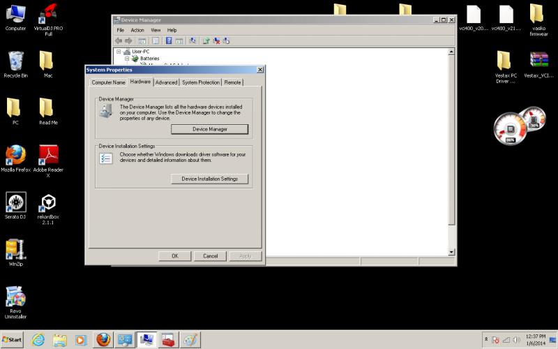

Pigaine .. Device Manager, kane deksi klik se mia apo tis Pioneer 900 NEXUS--> Idiotites (Properties) kai meta stin kartela Leptomereies (Details). Dialekse tin epilogi Hardware ID (Anagnwristiko syskeuis) apo ti lista

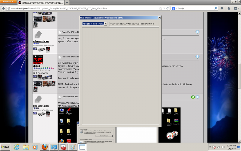

EDIT. Trekse kai auto http://www.virtualdj.com/download/hidtrace.exe me ta NEXUS syndedemena. Molis emfanistei to Hidtrace, des an stin lista panw aristera, emfanizetai i syskeui san epilogi

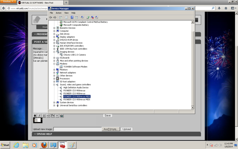

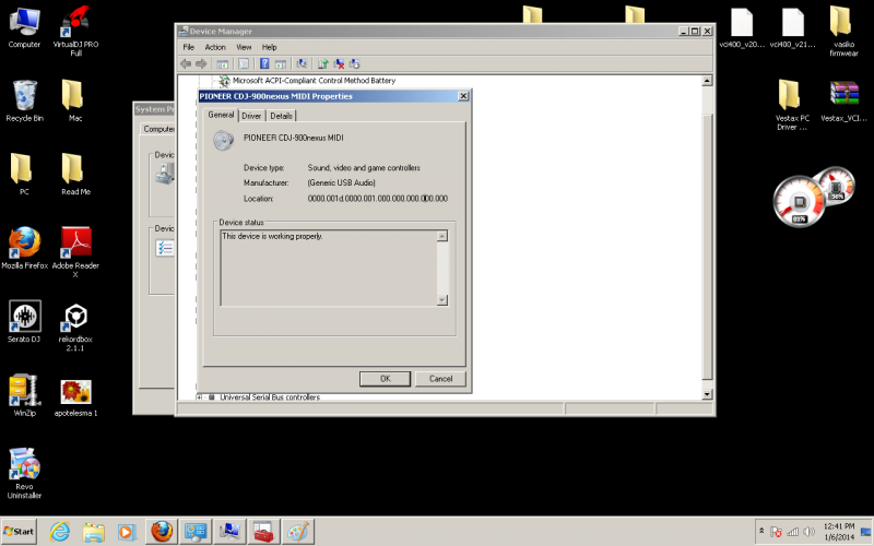

sto divice manager ta pioneer ta vlepei san pioneer nexus kai to dexi klik exei ayto san apotelesma
kai san pioneer 900 nexus midi poy sto dexi klik exei pali ayto edo san apotelesma
soy anavazo kai to divice manager na deis

etrexa kai to programa soy deixno kai to apotelesma
