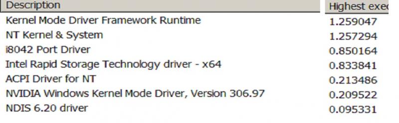

Exactly, that is why I showed the report as someone asked, included in the above report I found this:
Highest reported total DPC routine time (%): 0.493722
Driver with highest DPC total execution time: USBPORT.SYS - USB 1.1 & 2.0 Port Driver, Microsoft Corporation
Highest reported total ISR routine time (%): 0.319515
Driver with highest ISR total time: dxgkrnl.sys - DirectX Graphics Kernel, Microsoft Corporation
note: Also, the pictured graph above may mean a lot more to someone else than it does me.
I don't know what kernel timer means, maybe someone else does.
I don't understand much about hard pagefaults either.
The Hoster Karaoke Program showed the most.

Another test for a longer period of time showed these results
ISR ...... USB1.1 and 2.0 - 2,101 uSec
DPC..........NVidea Windows Kernel Mode Driver - 2,053
DirectX Graphics Kernel - 1,002
Intel Rapid Storage - 967
TCP/IP - 673
note: Sometimes NDIS 6.2 Driver and i8042 Port Driver is up there in the top 5
The numbers seem to increase as the time builds up????
I have read that some of these latencies still exist even if the offending device is turned off.
The other day I had an audio drop with the Karaoke program (Crackle, stutter, then out of sync till end of song, then program crash)
and I did not use the usb port for the audio, I used the onboard sound card instead.
I did see on the report that the karaoke program had way more hard page faults than anything else.

NVidea Windows Kernel Mode Driver is your video driver, so there could be a fault with your video drivers. Make sure that you have the latest drivers installed (Check your computer manufacturer's website for any updates.)
USBPORT.SYS is the USB driver. Make sure that you have all the latest Microsoft Windows updates installed. If you search Google for 'USBPORT.SYS latency issue' you will find other users having similar problems. If you have all the latest Windows updates installed and the drivers/firmware updates from your computer manufacturer also installed, you could try the following hotfix from Microsoft: http://support.microsoft.com/kb/2529073
NOTE: For accurate results, make sure that you run LatencyMon without any other software running (VirtualDJ, Karaoke Hoster, web browser, etc.) Do you get similar results if you don't have the mixer connected?

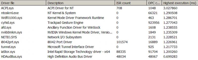

This is another report while my wifi radio was off and Hoster was running in auto mode for about two minutes. DPC Checker said absolute was 1300 uSec and yellow spikes in that range occurred about every 20 seconds. Also, I was NOT hooked up to an extended monitor either, if that matters, and was playing straight from the internal soundcard.
Does this tell anybody about anything that I can do to help out the audio drops situation?
Posted Tue 11 Dec 12 @ 12:32 am
Another 4 minute test. The only difference from above was the fact that VDJ was on the screen (had a video loaded on deck B but wasn't playing, just Karaoke Hoster was running in auto mode.
Any more ides on what this is telling me?
Posted Tue 11 Dec 12 @ 1:00 am

Regarding DPC:
Sometimes no matter how much you tweak your system, you can't get satisfying results. Each system is different, with different components, different drivers e.t.c...
I own several systems due to my day job.
Two of my systems are almost similar. Initially they were bought as identical systems, but I had to change the motherboard on one of them after a month or so due to some new needs of my day job equipment (I needed a MoBo with a Firewire port).
Now here's the interesting part: On the second system the nVidia kernel driver misbehaves all the time. It produces very big amounts of DPC and in general it makes the entire system useless for dj-ing purposes. No matter how much I tried, no matter the endless tweaks, the formats, anything... I haven't managed to find a way to make this system suitable for real-time audio... I even tried to change VGA cards, still nothing!
However the first system runs flawlessly!!!
I repeat that both systems are almost identical! Even the new MoBo of the second one is from the same company, same series, same chipset, and just a different model!
What I'm trying to say is that due to some hardware components or some bad drivers you may not be able to make a system better after a certain point of improvement. You'll have to accept that... Also even DPC and LatMon can give you the wrong impression on what's wrong with a system. On the system I mentioned above it's not the VGA card responsible for the high DPC. It's the Mobo. Something in it cuases the VGA to misbehave. The same VGA on another MoBo of the same series behaves correctly!
