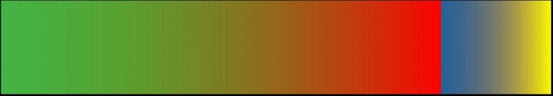

I finally understood your code (after hours of searches and test!). It is very ingenious !! Bravo !!
But I would have liked knowing what colors you chose to have a beautiful result ?
I use this for the moment :
but it's not brilliant...
Posted Wed 12 Dec 12 @ 10:10 am
It is good, I managed alone.
