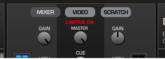

The new 7.3 version has introduced Limiter, and a new get limiter action
The action is not showing if the Limiter is enabled in Config->Options, but it returns true each time the signal is compressed by the limiter.
In other words it should show the user, that something is wrong in his mixer settings if he get that indicator. You can understand of course the importance of this indicator, as quite a few times users complain about distorted sound (now you know why ;) )
The Default skins has been modified to include this feature
2 Decks : http://www.virtualdj.com/addons/15354/VirtualDJ_7_(2_Decks)_HD.html and http://www.virtualdj.com/addons/15333/VirtualDJ_7_(2_Decks)_(Browser_Resize).html
4 Decks : http://www.virtualdj.com/addons/15391/VirtualDJ_7_(4_Decks)_HD.html
but all skiners, even novice users could implement that to their own skins, as its quite easy (doesnt even require graphics)
You will need just a few extra lines in your xml files...
The above lines will make a text ..LIMITER ON to light up on the top of your screen (690,3), each time the limiter handles the high outputed signal.
PS. You might need to edit the position (690,3) of course, as it might overlap some other element in your skin or you may place that anywhere in your screen/skin.
Hope that helps.
Hope that helps.

I swear your a mind reader!! I was just gonna ask if this is possible.
Thanks for th's info!!
EDIT: Works Perfectly!!

Many thanks djdad,
works great for me - I have added it to the 4 deck swap skin @ the top left hand corner near the VDJ logo as I found your suggested position interfered with the other panels.
But like you say, can put the output text anywhere.
I now have a limiter indicator on all 4 decks.
here's my code:
Thanks again.
here's my code:

Is it possible to have a red flashing circle (to emulate a peak LED) above each channel meter?
Posted Fri 23 Nov 12 @ 8:41 am
Yes its possible.
Instead of a textzone, you can have a button..
<button panel="limiteon" action="blink & nothing">
<pos...>
<size..>
<up..>
<selected ..>
</buton>
but have in mind that limiter is engaged differently depending on your Sound Setup.
If you use Headphones in Outputs. (internal mixer), then the get_limiter is returning true and the limiter applies on master. If you use ExtMixer as Outputs (external mixer), then the limiter applies on each deck so you will get true from deck x get_limiter.
The first method i described doesnt use graphics, so its easier to implement. The above method requires some graphics to be added.
Alternatively you can have the textzone to fllash , i ll come up with a code and post later.

VIP DISCO & KARAOKE wrote :
Many thanks djdad,
here's my code:
Thanks again.
here's my code:
Quote :
LIMITER
<panel id=\"limiteron\" group=\"limiters\" visible=\"get limiter ? true : deck 1 get limiter ? true : deck 2 get limiter ? true : deck 3 get limiter ? true : deck 4 get limiter ? true : false\">
<size width=\"120\" height=\"28\"/>
<pos x=\"86\" y=\"4\"/>
<down x=\"+0\" y=\"+0\"/>
</panel>
<panel id=\"limiteroff\" group=\"limiters\" visible=\"get limiter ? false : deck 1 get limiter ? false : deck 2 get limiter ? false : deck 3 get limiter ? false : deck 4 get limiter ? false : true\">
<pos x=\"86\" y=\"3\"/>
</panel>
<button panel=\"limiteroff\" action=\"nothing\">
<Tooltip>Limiter Indicator</Tooltip>
<up x=\"+0\" y=\"+0\"/>
</button>
<button panel=\"limiteron\" action=\"nothing\">
</button>
<textzone panel=\"limiteron\" >
<text font=\"Eurostyle\" size=\"20\" weight=\"bold\" color=\"RED\" format=\"LIMITER ON\" align=\"left\"/>
</textzone>
LIMITER
</panel>
</panel>
</button>
</button>
</textzone>
Thanks again.
