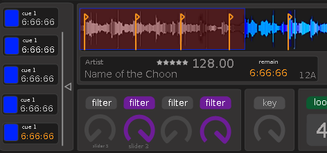

In regard to the "songpos" element, could we get the ability to color the wavform the for "selected" & "volumeselected" the same as "down" & "volume"
the reason is I am using "down & volume" (not yet played) colored to show the song remaining, and want "selected" & "volumeselected" (already played) to be grey but so you can still clearly see the waveform, at present "selected" greys out the area I want to be black making it difficult to see the waveform.
Posted Sat 19 May 12 @ 4:09 am
Hmmm unless you mean something else, that is already possible
<songpos deck="1" orientation="horizontal" waveform="yes">
<size width="570" height="27"/>
<pos x="11" y="202"/>
<up x="11" y="+0"/>
<down x="9" y="2603"/>
<volume x="9" y="2564"/>
<selected x="9" y="2447"/>
<volumeselected x="9" y="2486"/>
<upselected x="9" y="2525"/>
<cues>
</cues>
</songpos>
Posted Sat 19 May 12 @ 7:43 am
"upselected" did it! thanks Bob :-D
it's not in the skin sdk wiki, do you think you could add it in for future reference?
Posted Sat 19 May 12 @ 8:05 am

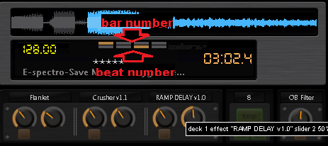

could we get a new verb "get bar_num # 32" in vdj8
it should return true if the song is in a particular bar out of 32 beats. But I could do the same thing if "get beat_num # 16" was increased to 32 beats. The reason I want this is so I can have two beat bars, one for the bar and one for the beats as shown below.
I did consider using "get beatpos 1", "get beatpos 5" etc... "get beatpos 9" etc... "get beatpos 33" etc... but because most songs reach 700 beats it would simply be too long to script.
Also "get beat" works on controller leds but not skin pannels to flash with the cbg..
Posted Fri 25 May 12 @ 2:44 am
get beat works, but you should understand how it works:
It returns a value ranging from 0 to 1. In order for a panel to show, get beat should return 1. That means that the panel will be visible ONLY when the beat has FULL intensity.
A work around for this is to either create a visual element that will use get beat, or change your panel visibility with get beatgrid
get beatgrid relies on the beatgrid and will return 1 (true) when the track is on a square of the cbg.
Posted Fri 25 May 12 @ 2:58 am

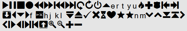

could the way text is rendered on skins get looked at, I found a fantastic one called "guifx transport V2" so I can use labels on all the buttons without drawing individual types, but in vdj the text looks terrible.
http://blog.guifx.com/2009/04/02/guifx-v2-transport-font/
Posted Fri 25 May 12 @ 11:38 pm
That's because of anti-aliasing. Each program uses different method to do it. Most programs rely on the OS to do the job. However VDj doesn't and I'm sure it can be improved :-)
PS: If you try different sizes you'll notice that some sizes display better.
Posted Sat 26 May 12 @ 4:53 am
