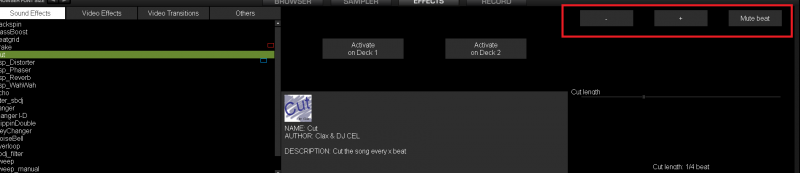

hi , i have ddj ergo and im confused on what those buttons 1, 2, 3 under effects peramiters do they dont light up or nothing when pressed..
im thinking u can map them somehow please help!! anyone else have an ddj ergo?

The FX buttons 1,2,3 control the first 3 Effect buttons of the selected effect. Note that not all effects have buttons. Most of them only have sliders, so for some effects, those buttons will not do anything.
You can map them differently of course, and assign to those buttons something more important depending on yor mixing style.

i think i get ya.. ill try it tonight, i have not mapped at all kinda leary of it , i dont wanna screw up my controller..
