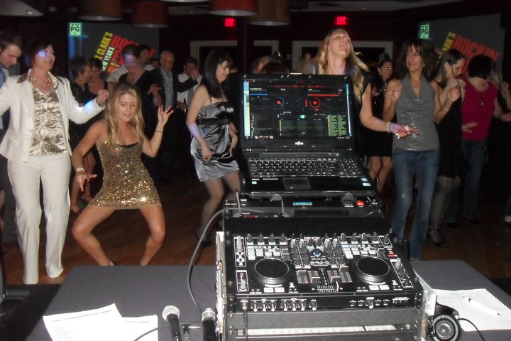

I got my MC6000 about 1 week ago. I used it for a New years eve gig with Virtual DJ Pro and I have a Super fast computer with lots of Ram.
It worked perfectly. I made lots of use of the Samples, Effects, Mic EQs on both mics and even tired the Echo effect on mic. The Sync button right on the MC6000 was so sweet! Way better then before when I used the HD2500 as Midi with VDJ before.
If anyone is wondering if the want to get this unit. I really suggest it. I know some folks have had issues with MC6000 but I think most of them are related to incorrect settings in VDJ or on the controller. Set your software back to factor settings and go step by step when setting up the MC6000 and you will be good to go as long as you have a good running computer.
Here is a photo from my gig NYE event.
