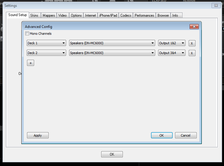

DJ-Evangel wrote :
okay.. now i just installed win 7 x32 new and had to config exactly like in the manual for 2deck mode...
its not working for me.. now i have deck a on channel 2 and deck b on channel 2 AND 3.... i was trying it for an hour and noting would work.. also i resete the midi channels....
Thanks for your report
For 2-Deck Skin...
Did you switch the mode to INT on the rear?
Did you select Aux or Line input for CH 1 & 4?
Did you select MIDI input on the mixer for CH 2 & 3?
Did you select External Mixer in the audio setup?
hello,
yes i switched it to int mix and the settings was exactly like discribted in the quick start for virtual dj.
but got the problems...
back to the 4 deck pc mix mode everything works fine for 3 hours last night in automix mode.. perfekt sound, nothing freezed..
i really want to keep my mc6000 but, but also want to use channel 2 and 3 for deck A and B, so the only way for that is the 2 deck int-mix mode? right? that is not working for me so far.....
and if i use the int-mix mode is that right that the sliders/faders(knobs dont move in virtual dj as it is also by the vms4? can i use this "fake-actions" to bring it on screen as i have it by the vms4 or not?

Its not the best work around but... If you use the advanced sound card configuration and choose Speakers (DN-MC6000) and set up your sound for 2 or 4 decks the crackles and pops go away. Also ASIO in the advance audio is currently not working.
Here is a screenshot of a 2 deck advanced setup.

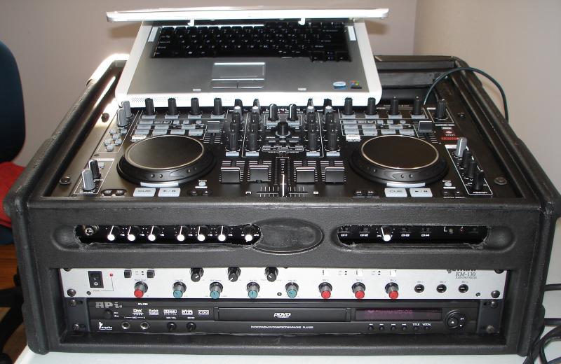

Check my new rig!

Check my new rig!

Hey Crowdpleasers,
I like how you modified the case to allow access to the knobs on the front of the MC6000. I've thought about buying one of these to allow me a smaller system that I can take to smaller events. Are you using any type of EQ with the Denon unit, or using it with a straight feed to your amps/speakers? How does it sound? How about the microphone input, does it provide satisfactory sound without being too hot?
Thanks,
Ross Henning
Tunes 4 My Party Houston DJ
Thanks,
Ross Henning
Posted Sun 09 Jan 11 @ 6:44 pm
