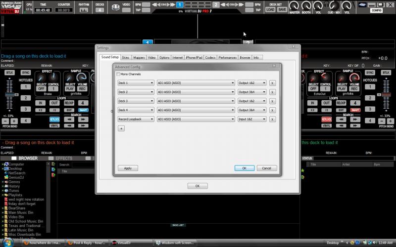

djxlbass, i think you have to assign
Deck 1 Output 1,2
Deck 2 Output 3,4
Deck 3 Output 5,6
Deck 4 Output 7,8
Do you use the crossfader? How is it assigned ? (Front side of the VMS4.)

on the German you-tube video they actually had that config but it did not work for me. ???
on the front i have it set to 4 as opposed to 8 and all channels usb. crossfades 1,3 over to 2,4
pfl work as well.
now with different skins i got different results. the vms4 2.1 is what i used
pfl work as well.
Posted Wed 03 Nov 10 @ 2:21 am
Deck 1 Output 1,2
Deck 2 Output 3,4
Deck 3 Output 5,6
Deck 4 Output 7,8
Deck 1 Output 1,2
Deck 2 Output 3,4
Deck 3 Output 5,6
Deck 4 Output 7,8
you were correct. thanks :)
http://www.youtube.com/watch?v=9yXDrF53PwY
Posted Thu 04 Nov 10 @ 3:48 pm

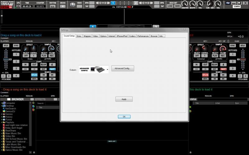

HI Guys.. sorry to bother you, i am almost there.
deck 1 - output 1&2
deck 2 - output 3&4
deck 3 - output 5&6
deck 4 - output 7&8
the crossfader is set as off
i have deck 1 live but only plays out left hand speaker, i have deck 2 down & i am cueing up the deck put it comes out right speaker when there should be no sound .
decks 3 & 4 work perfect.
I know it is probably something silly but i have tried everything.
I have also changed pflls
ch1 pfl - deck 1
ch2 pfl - deck 2
ch3 pfl - deck 3
ch4 pfl - deck 4
Any help is appreciated - getting frustrated & know it will be something simple.
Cheers

i will try to help.... the crossfader is set as the video shows...make sure you are using the vms4 2.1 skin
crossfader A set to 1 B set to 2 ..... 3,4 are independent via channel faders
