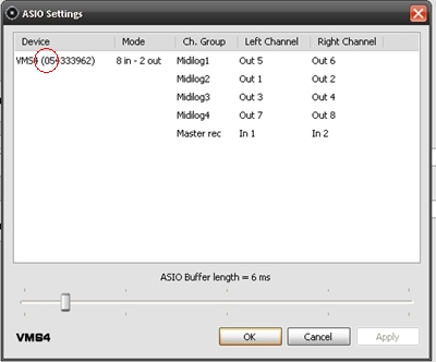

QUESTION: wich is the first number in the ASIO config ? zero or one...

i have it set to post so its a 1 or 2 i believe. i had the TC crackles on both settings.
Posted Sun 09 Jan 11 @ 11:25 am
2 is not possible... the setting available is:
0 = controlled by midi
1 = controlled by software
