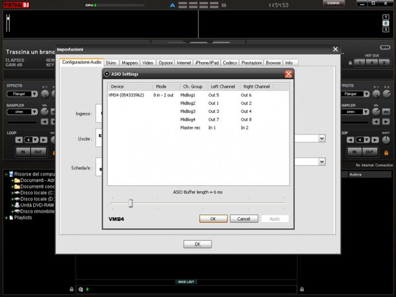

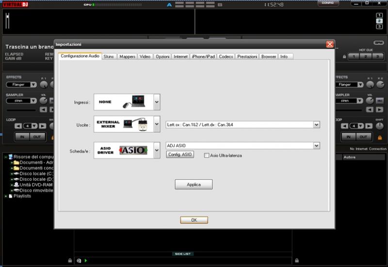

@vivern & @ cram
the first... update the firmware and see the led on the VMS4 when turn on... in the left side see the first number in the right side the second... example: 3 led in left side and 12 led in the tight side... your firmware is 3.12.
the second... setup virtualdj... see the pic under...
