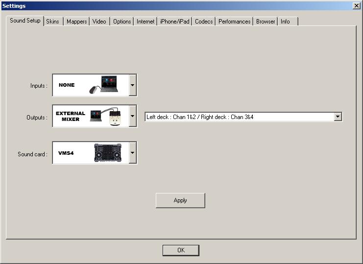

Having problems with recording my mix with the VMS4, my headphone sound comes thru on my mix and can figure it out, what are the proper settings?
My config is currently this way
