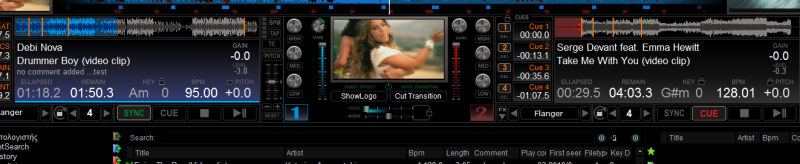

"apomeinaria grafikon apo tin orange..." =atyxis ekfrasi.
Ta plaisia ston mikti exoun ena ;gkri-portokali ; xroma ou den denei me to ypoloipo kai ta ypoloipa plaisia sta players.
Epeiseis den mou aresei (se ola ta panels) to background sta vu meters kai idiaitera to ena kai monadiko kitrino..
Mikra psegadia bebaia... kai oso gia to audio panel mallon den tha to xrisimopoiiso.
Posted Sun 11 Apr 10 @ 3:08 am

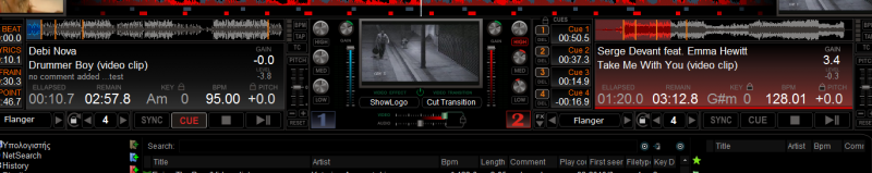

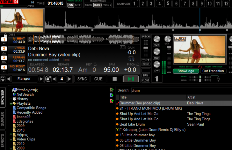

Ready for download kai me .exe :)
Posted Mon 12 Apr 10 @ 7:17 am

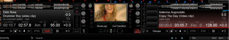

Katarxin euxaristw gia to sxolio.
Sto epomeno upadate (ver 3) tha prostethei kai mia Dark version
Parte mai geusi apo to aristero deck.
Giwrgo .. tha to vrw kai tha postarw.
Posted Thu 15 Apr 10 @ 5:57 pm

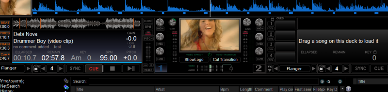

Auto to exete ksanadei se skin????? xexexexexe, exei ena mikro bug pou prospathw na to lysw, alla pou tha mou paei..
Deck 1 selected
Deck 2 selected
Deck 1 selected
Deck 2 selected

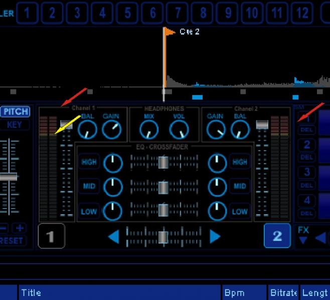

Mpambi, mou fainetai edo eimaste...
Blepo piges sta dokimasmena mple-kokkino, giati oxi.
Kai an sou bgei telika mia version (kai kali) anti gia 3, akoma kalytera. Keep it simple..
Tora gia ayto pou legame me to Tc signal... sou brika tin teleia thesi:
Mias kai to tc-signal antiprosopeyei ta input tis kartas (ok deixnei quality oxi level alla poly mikri diafora exei) prepei na to baleis :
-Anamesa sta vu-meters, gia kathe deck, opos ttin beta pou mou esteiles as einai mia lepti katheti mpara anameas sta vu..
H akoma kai dipla sta vu, opou se bolepsei kalytera, h akoma an den se pernei bale mono vu-meter kai dipla tin mpara.
Etsi me mia matia tha blepeis ti mpainei kai ti bgainei stin karta, kai an yparxei ksexasmeno tc cd sto play epeisis tha einai emfanes..
Gia ta rotated knobs opos sou ta elega, etsi mou fanikan kai sto magazi.
Pio omorfa isos, alla ligotero leitourgika, eprepe na diplotsekaro me to mati...
Posted Mon 19 Apr 10 @ 9:01 pm

Prosopika to stelno terma aristera i deksia me keyboard shortcuts pros to paron.
Sta cd einai synithos 0 /1 katastasi. H douleyei i den doulevei. (xoris na einai apolyto)
Ti stigmi pu patas play kanei ena poly grigoro gemisma apo 0 ->100 %, alla paizei otan kaneis scratch / cue
Me tc vinyl mporei na exeis metabalimeno pososto pou na kymainetai px apo 75-100% kai ayto i na tremopaizei i na metabaletai arga, px na xaneis oso proxoraei o diskos i gemizei bromia i velona.
Se kathe periptosi den blepo logo na kaneis poles diabathmiseis kai na miazei me vu-meter.
Mia statheri katheti mpara [anti ta leds tou vu-meter] pou na exei stathero xroma i na kanei mia diabathmisi fade apo ena xroma se allo (i sto idio xroma anoixto-skouro) tha itan ok.
Ps, tha mporouse na ginei kati tetoio kai sto video crossfader oste na katalabaineis kai apo to xroma oti paei pros aristera i deksia.
Gia na katalabeis ti sou leo des pos einai sto Condenced skin ta faders, pou malista sximatizei ena trigono i diabathmisi.
Kai leo to video x-fader giati einai simantiko na blepeis pou brisketai ara ti bgazeis ston "aera" afou sinithos den exoume hardware fader gia ayto.

Stin ver 3 tha prostethei kati pou mexri twra den ypirxe se kanena skin.
Ta Deck Selectors tha fwtizoun ta decks wste na einai orati i epilogi tous me mia matia....!!!!!!
Deck 1 Selected
Deck 2 selected
Syntoma diko sas !!!!
Deck 1 Selected
Deck 2 selected
