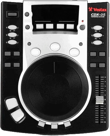

What is the best way to trim this player. I started but trying to remove the white around it is not easy in my software.
This is my first project. I know what I want. I have the slightest idea of what im doing. Where do I start? Much help is appreciated.

Hi,
I personally use Photofiltre when triming white around pictures. But I think using Paint.Net or Photoshop could be better.
You can try setting the white color as transparent, but this might make part of the white in the deck transparent too.
Other solution is to use a flood fill with pink color and make sure only the white around the deck is changed to pink, and then set pink as transparent. And correct by hand every little pixel that isn't transparent.

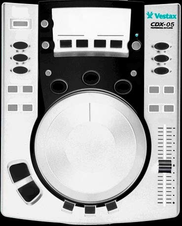

I have skin creator. Nice work. I have know idea how to use it. I tried to invert the pic. that was the first thing i did. it looks cool but the lite areas went black.
The top is the problem im having.
Ok im using paint.net. I used the magic wand, removed the white and saw the grid in the back. When i export and pull up in another program, its still there. What is wrong?
What format are you saving them as? For example if you save them as a .jpg the program automatically fills in the background. I would try saving them as a .png. See if that gives you the results your looking for.
I'm not sure how far you have gotten with paint.net but that is what i use and on the magic wand tool, there is a sensitivity level you can adjust. If your trying to cut out an object and it selects too much try lowering it. Sometimes I notice it varies on where you put the cursor, so play around a bit and see if that helps.
That was the prob. I found that out last nite. I remembered that from when i did my logo. Thats exactly what was wrong. Thank you guys.....For now.LOL.......No im serious, just for now! Please monitor this thread.

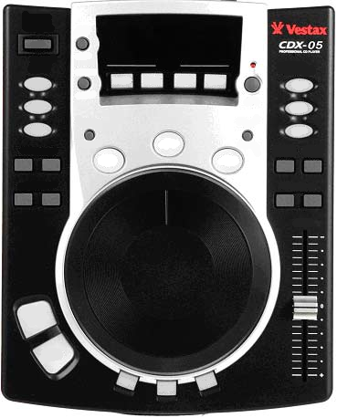

I\'m not sure how far you have gotten with paint.net but that is what i use and on the magic wand tool, there is a sensitivity level you can adjust. If your trying to cut out an object and it selects too much try lowering it. Sometimes I notice it varies on where you put the cursor, so play around a bit and see if that helps.
I was good a 50%. So, I just use the paint brush to close off the problem area. it came out ok. You think?
looks good to me mate!! good luck with the skin =)

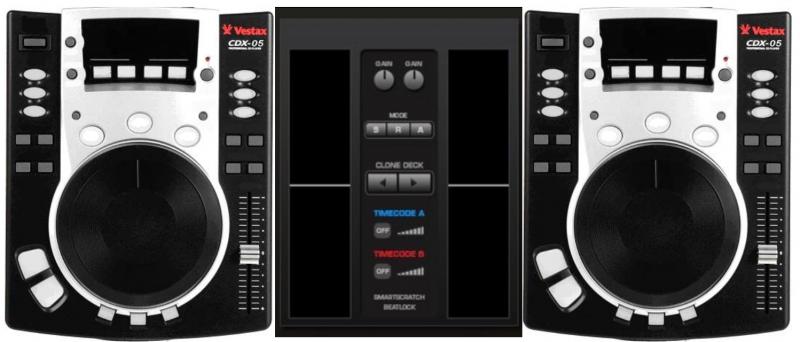

Ok. On the bitmap. Are these images in a certain place or are they a reference to what is in the actual skin? Does the XML tell the bitmap what to do? Correct me my SENSEI(s). ((((GONG!)))) LOL!
I admit, I have never created a skin myself. But, from my understanding of the process, you are mapping a grid coordinates via the XML data, to specify a certain action. Hopefully L2 or another skinner will chime in with the correct info.

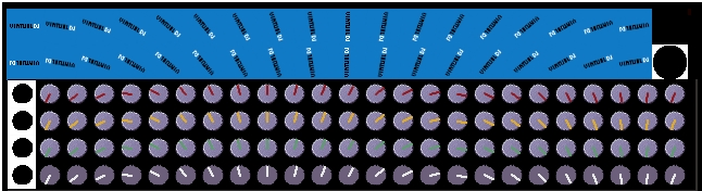

Ok. The bitmap. how do I create the rotation series for the platter and knobs.
the best way to create a skin is to study some excisting skins. Try to open a few xml and bmp files and study line by line. When you learn how it works, try to make a very simple skin first or try to modify one of them.
Yes, the best learning comes from studying other skins. Dont worry about coding for now just try to finalize you .BMP image with a layout that you like.
Just be thankful for the skin creator program, it can save so much time (I love you Jermek) and can assist in the understanding coding.

Ok. I am a quick learner. Sorry if i jump the gun. I am working on the .bmp. This is what I was asking as far as my last question; How do I do this
In what intravals of degrees should i use?
There is a much easier way of doing this. Look at the default vdj6 skin. ;-)

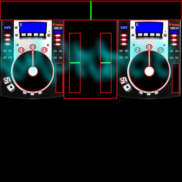

Skin preview
As far as the browser. It will be simular to the default. Open for sugestions and "CONSTRUCTIVE" criticism.
Thank you for your time and help.
Looking good mate. The browser has to be default- the only thing you can change about the browser is icons and background. The browser function itself is standard!!
