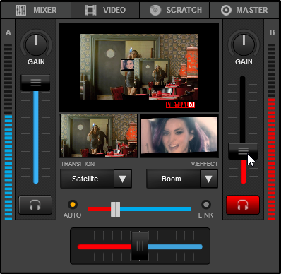

2 deck video mixing

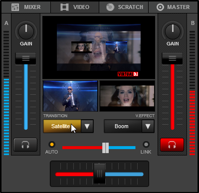

Video between the left and right decks is mixed based on the position of the Video Crossfader. The Video crossfader can be moved individually (when MANUAL is selected), linked to the audio crossfader (when LINKED TO AUDIO is selected) or operate in Smart Mode (when SMART is selected). These options can be selected from the Video Output Menu.
Video Mixing with the Video Transition Button
Video can be mixed manually (when MANUAL mode is selected), using the Video Transition button. Each time the button is triggered the Video crossfader will gradually move from one side to the other, using the selected Video transition.
The time needed to move from one side to the other can be defined using a different interval with the "video_transition Xms" (where X equals the time in milliseconds) action assigned to a custom/controller button (example: video_transition 2000ms will move the video crossfader from one side to the other in 2 seconds.)

The crossfader and Volume faders of the controller/mixer send MIDI messages that are assigned with VDJ-script actions to control the audio crossfader and Volume faders of the internal VDJ mixer. The video mix behaves differently depending on which option is enabled:

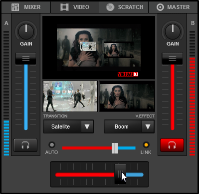

1. LINKED TO AUDIO Enabled
Video mixing follows the audio mixer if the crossfader is used to mix audio and LINKED TO AUDIO is enabled from the Video Output Menu. In this situation, the video mixing is done with the Audio crossfader of the mixer, controller or mouse and the Deck Volume faders are set to the maximum (up) position and are not being used.
Use the Crossfader of your mixer, controller or the Audio crossfader in the software with your mouse to mix both Video and Audio (linked).

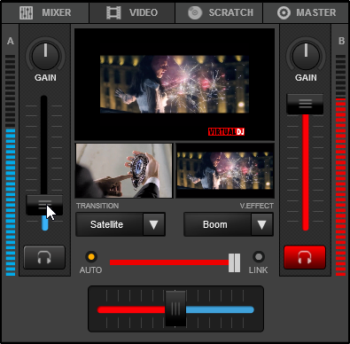

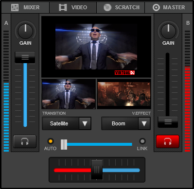

2. SMART Enabled
If SMART is enabled, video mixing will be done automatically depending on which deck is playing out live. This method is mostly used when the Volume faders are used to mix audio instead of the Crossfader.
When only one deck is playing and/or the Volume fader of the other deck is lower than 20%, the Video crossfader is automatically set to the side of the playing deck.
When the 2nd deck is playing and its Volume fader is moved above 20%, the Video Crossfader is automatically moved 20% away from the 1st deck (video transition is engaged).
If your mix is a long transition and/or you don’t wish the audience to see both videos showing up for a long period of time, you can use the “None” Video Transition (or any other similar transitions available that mix video).
To complete the transition (video mix), the first deck needs to either be stopped or its volume fader needs to be set to a position lower than 20%

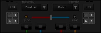

1. Automatic Assign
By default, all 4+4 Video Crossfader Assign buttons are assigned. The Deck selection for the Left/right side of the Video crossfader is done automatically based on which Deck is assigned as LEFT or RIGHT (using the LEFT/RIGHT buttons on the decks)

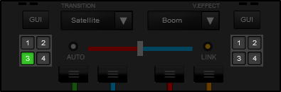

2. Manual Assign
You can manually select which deck will be used as Left/Right side for the Video Crossfader, by using the 4+4 numbered buttons placed on the sides of the Video crossfader in the VIDEO panel. In the example, Deck B has been manually selected as the left side of the Video crossfader and Deck A has been assigned to the right side of the Video crossfader.
Note: The deck video previews of the will always show the LEFT/RIGHT selected decks, regardless of which deck is set to the Left/Right sides of the Video Crossfader.
